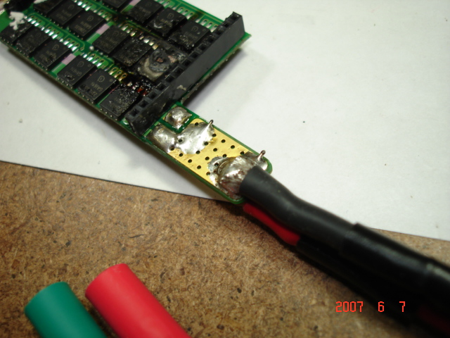

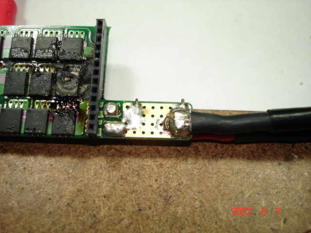

Anyways, I was looking at my burnt quark, and confirmed that the leads on the caps were vaporized.... some how? Check it out, I don't know if you can see it or not very well.

06.07.2007, 02:09 PM
Looks almost like both caps developed an internal short. :032:
06.07.2007, 01:01 PM
Yep, I see that alright. I fell hungry looking at that.... toast for lunch I reckon. There must have been one hell of a surge/short/whatever for the leads to melt down like that.
As for the cap-bank AAngel, neat is only a word. You wouldnt know there were any on there if you hadnt said, just a mysterious block piggybacked to the esc. Nice work.
