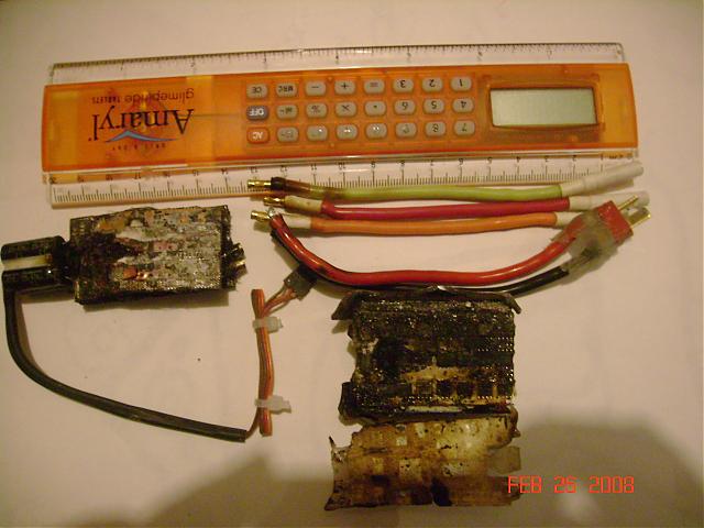

Ok. Got an e-mail from Schulze and this is what they said:
"Hello,
thank you for the photos - but unfortunately you did not take a picture of the important cause of the failure:
Please unmount the controller and the batteries, put them on a table with stretched out cables and a folding rules beside. Take also photos of the power connectors."
Ok, now I need to know what he means by "folding rules beside". This is really impressive as I was planning on buying another 40.160 a few months back and they never replied to my e-mail.

I will do what Mr. Schulze asked me to do and take it from there. The first video with the Mega, I didn't have any issues. Do you guys think do to the truck rolling backwards had something to do with what happened? I never had anything like this happen to me before.

Let me know if this are good for Mr. Schulze.

The length of the cable from your batterie(s) is missing on your pictures.
This is from the manual i found on their website (translated from german):
. cable length to your motor should be 10cm
. The length to the batterie should never exceed 20cm
-> Exception: Schulze 18.97KWF (max 30cm)
If your cable length do exceed those values, then you must add low ESR capacitors to the ESC.
Hope this helps.
