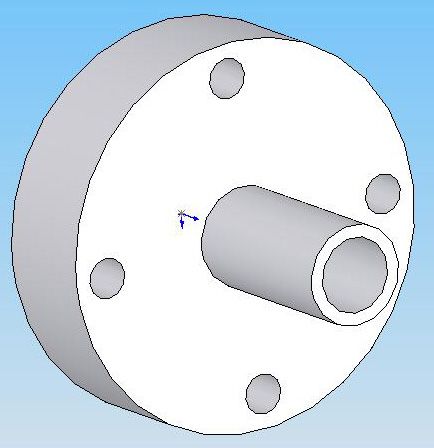

I was designing a back plate that would be compatible with a XTM diff. Ran into a problem. I don't know how an extened output gear could be gotten. If it were custom made, it would be expensive. But anyways, here is a picture of how far I got:
  (#35)
Gustav
Gustav's Avatar
Posts: 916
Location: UK
08.23.2005, 12:37 PM
On the diffs i've got(LST diffs) the diff out put shaft isn't permanently attatched to the out put bevel gear-just a shaft with a pin through driving the gear so all it would be is a long 6mm shaft with a hole through one end and an outdrive screwed to the other.
I wish i could post pics like that to demonstrate but i'm the world's worst with computers but you've got exactly the right idea.:)
