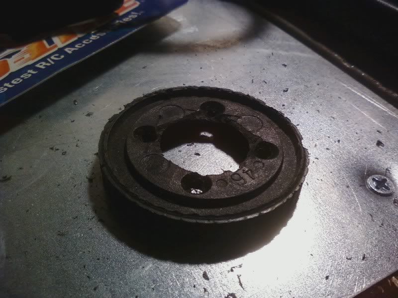

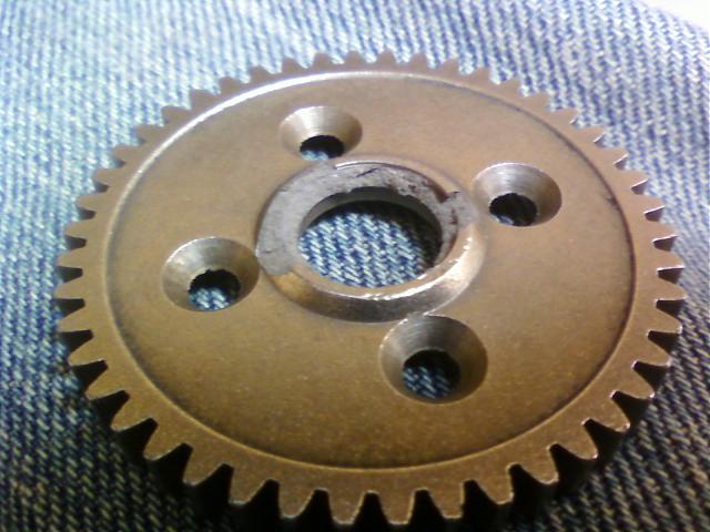

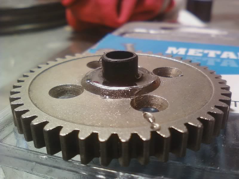

Here are a few pics of the dead gear and the new one.
The new gear is from a Cen Genesis, it had a different output then standard 1/8th scale diffs so the bearing race was pressed out by mike(can see it in the picture.. Going to have to take the bearing race out of the old spur and fuse it to the new, most likely with 2 part epoxy or Jb weld.
That little output doesnt see that much flex or stress....does it?

The bearing race is a press fit with 2 part epoxy to hold it all together.

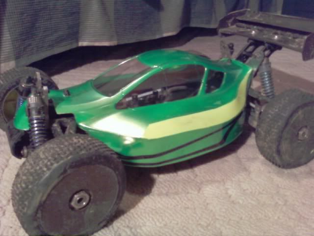

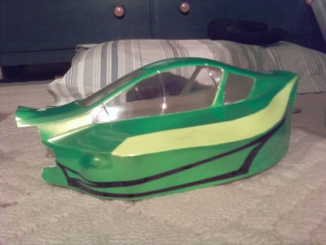

Ok so I finally got my body finished! here are the layers from outside to in.
1. Vinyl cut by my school's vinyl cutter
2. 3 layers of spaz stix gold to green chameleon paint
4. 3 layers of flourescent green
5. 3 layers of flourescent yellow
6. 3 layers of opaque white
dont look too bad for my first body job...
