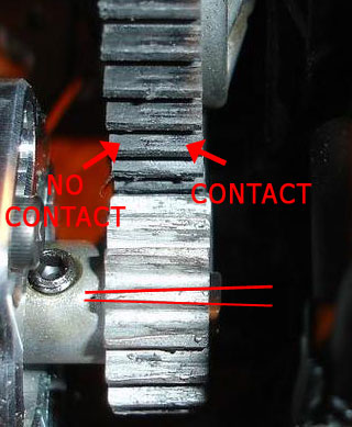

You mean your pinion wore like that against plastic spur?
Somethings fishy with those pinions, IMO - a decent hardened pinion does not do that even with metal spur.

Are you sure that your pinion was allright before you put it on place?
The teeth seem deformed and are/seem too thick at the right side (don't fit the spur), hence the noise & wear at spur.

Well didnt notice anything wrong when it came out of the package, that one there is the 16t and I bought a 15t so when I took it out last night I looked it over and its fine, odd thing is its narrower then the 16t was but as you can hear its making the noise to.

Is the mesh a hair too tight? Put the truck on some kind of stand and rotate the spur by hand slowly. Is there a certain point it grinds? There could be a high spot on the spur...

I have set the mesh so many different spacings just to see if it changes this noise and it does not why im left scratching my head on this, never had any issue getting a clutchbell meshed but this is retarded now. Why my thought was maybe the mount or something off, my eyes maybe are playing tricks but to look at the angle of the motor doesnt look the same as the spur, I mean if it does this noise on the full rotation of the spur and no matter how its spaced one would have to lean towards the angle being wrong right?
other than what you mention, the only other thing i can think of is the pinion itself... like i said - i was sent some .8 mod pinions, and they looked so close i didn't realise till i got hold of some proper mod1 pinions... They made the same grinding noise - you can hear and feel the gears 'clicking' off of each other...
Try what brian said - get a stand and move the spur slowly with ur hand - i usually hold a wheel and spin that slowly...

Yea it does it turning by hand to. Well doubt I will get the pinion by this weekend so maybe early next week and I will see how a different brand does, Robinson has a pretty good name when it comes to pinions.
