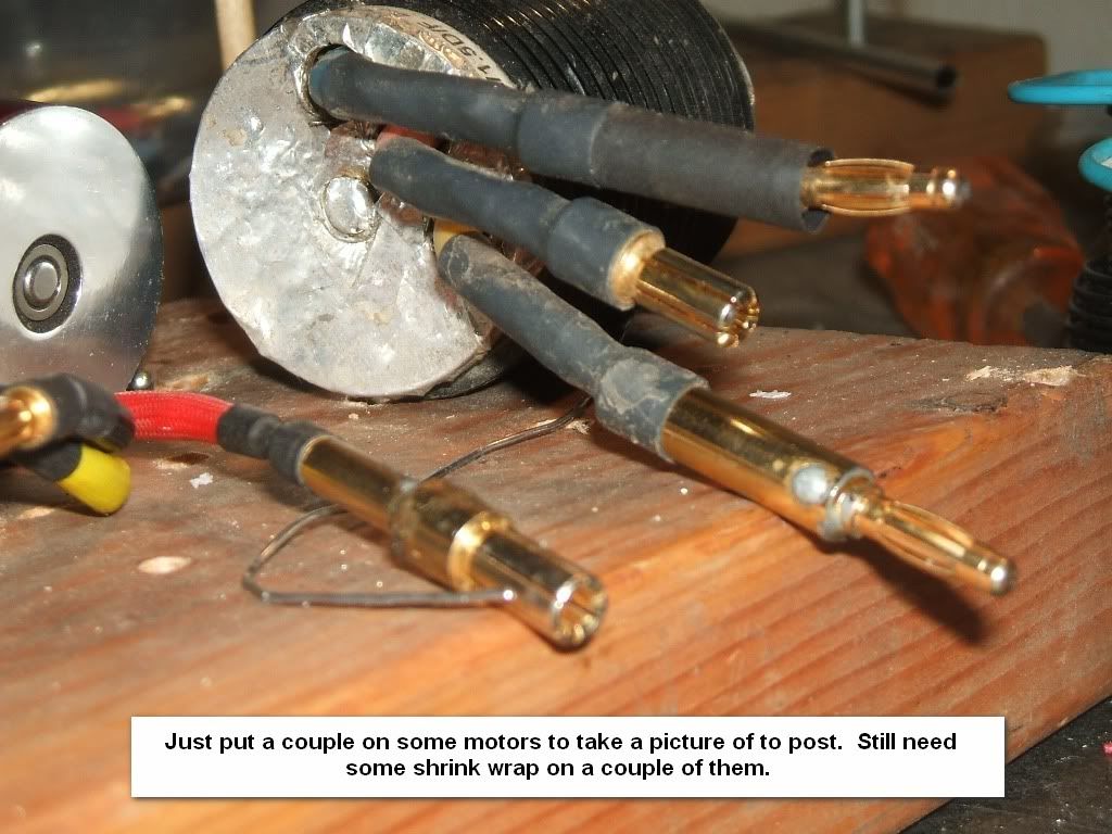

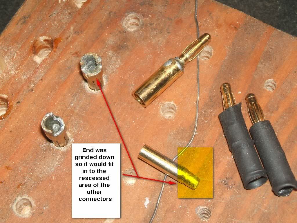

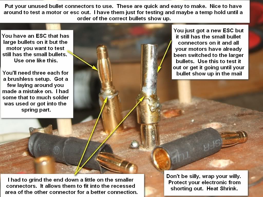

Adapter to connect 3.5 bullet to a 5.5mm bullet or vice verca - 01.25.2009, 10:50 AM
I bypassed the short piece of wire that I use to use betweem such connectors. I just soldered two connectors together to fit what I could use them for.
Adapter(s) for your bulllet connectors for those times you don't have the right bullet connectos handy.

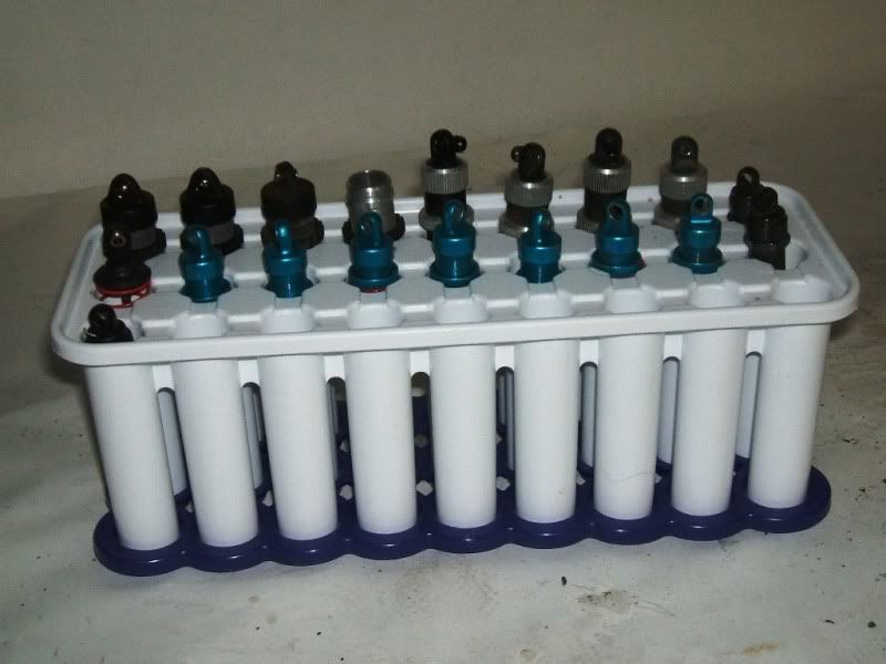

02.13.2009, 12:54 AM
Shock holder I found at a thrift store for .99 cents. I think it double as a ice tray too.
I've seen them at other stores also.
