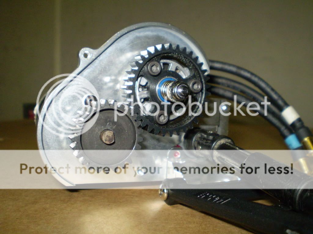

I've assembled the trans with 34 x 25...looks big
[IMG][/IMG]
SunnyHouTX
SunnyHouTX's Avatar
Posts: 396
03.09.2009, 10:09 AM
Looks about the right size Make sure the gear mesh isn't too tight or you will overheat that motor pretty quickly.

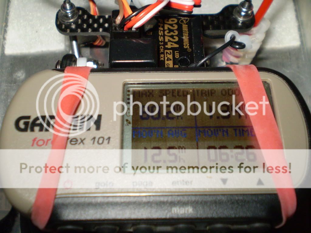

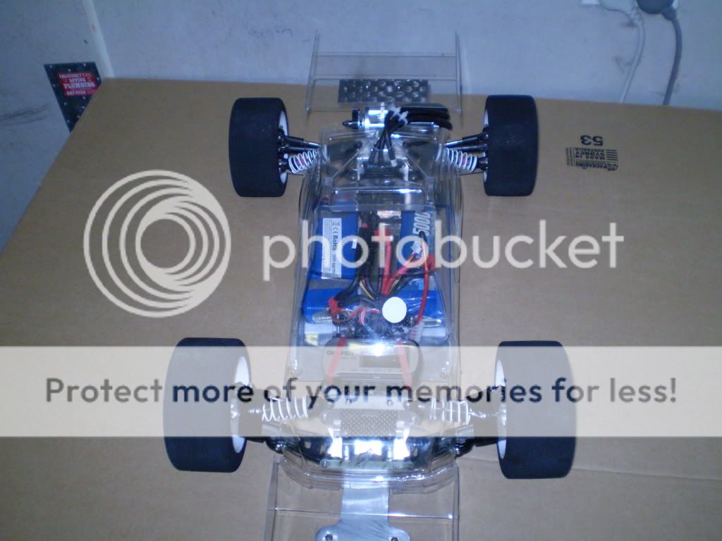

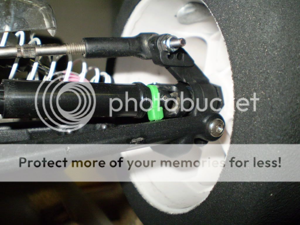

04.05.2009, 03:46 AM

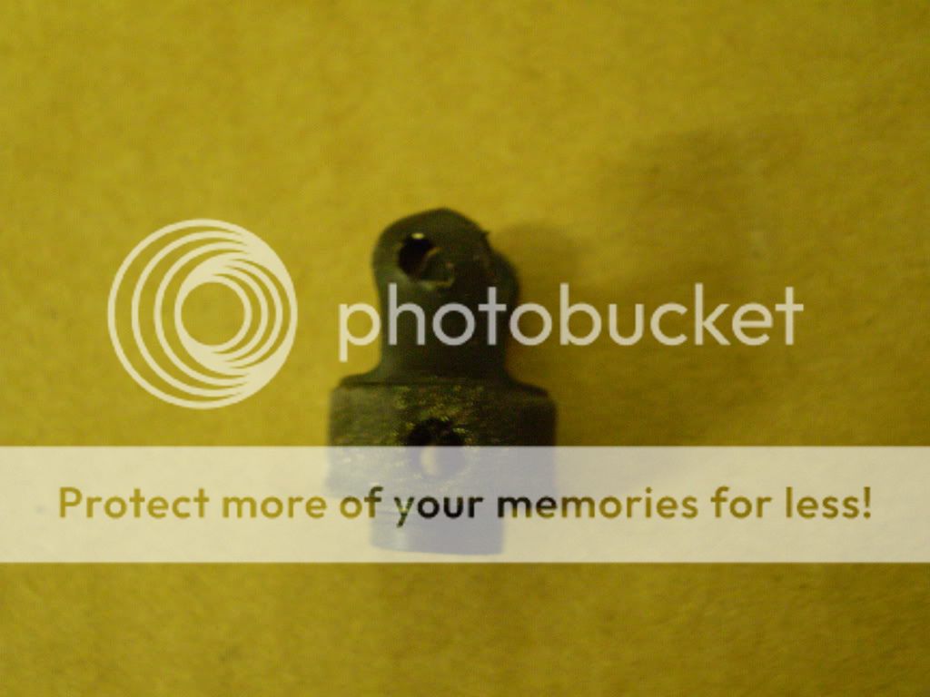

80.2mph today before the plastic yoke failed. The new sliders recieved some cable ties to help their casue which just transfered the torque to the next weakest link...
[IMG][/IMG]
[IMG][/IMG]
[IMG][/IMG]
I'm aiming for 90 next week if the steel yokes & Jato drive arrive in time
E-sav
04.05.2009, 04:06 AM
Still running the stock plastic yokes? Man, they went on my Slash with the VXL on 3s geared 31/76. How have they held on for those runs with the Neu?
Oh, and that Rustler is beautiful. Nothing like something that is built for purpose rather than pissing about.
