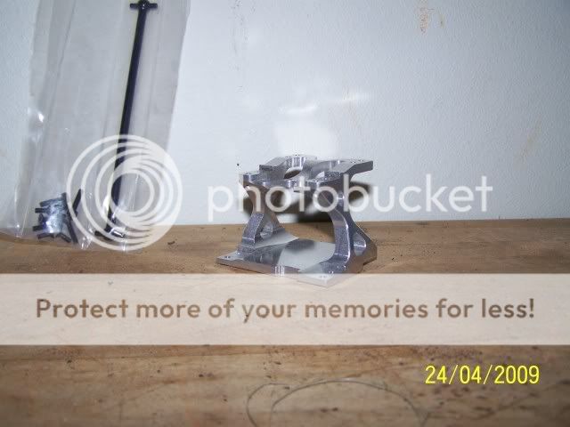

Hey Kcaz25, where did you get this center shaft and what length are you using?
Alien
Here ya go

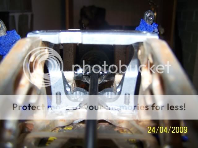

Nice... How did you like the fit? Is that a hex screw sticking out of the drive cup... Do you have too much play/movement with the shaft?

Yeah on both ends. There are other options for solving this problem, but I think this will work nicely.

Interesting... looks like a nice and simple fix. Thanks for the info man.

Umm...I wouldn't do that. Just use some o-rings in the drive cup...
+1
those screws might cause a ton of friction which will heat up your drivetrain some, o-rings would be the best solution.

Originally Posted by Sylvester View Post
+1
I was thinking about the excess vibration it may cause too... would simple rubber/foam inserts work by having them push out on to the shaft?
Alien
Rubber and or foam would work, i personally used gas tubing in between the output shaft and driveshaft and never had a problem.
