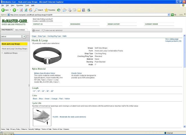

CHEAP STRAPS
McMaster Carr has great straps, and they are like $1ea. See pic.
It may or may not make sence for you to make these. The big advantage they are cheap, reconfigurable and can be made to ANY size. Some of the OEM trays are ok (like novaks, tekno etc) but they are limited in range of sizes. There are no trays for the 110mm sized 2100mah batts like I have in my .5. Most OEM trays don't fit 50mm wide batts either, let alone A123s or such.
Plus making custom stuff is a fun part of the hobby (for me anyways.)

BTW, if you get straps from MMC, make sure to order the std straps, not the heavy duty. The HDs sound like a good idea, but the velcro is only rated for 100 cycles, and doesn't hold itself well.
