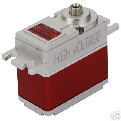

i have a couple of questions about servos. i have been looking for a 1/4 scale high torque servo. the highest rating i have found is like 300oz which seems low for a truck this size. i have the standard size JR9100 HVT servo which is capable of 480oz. so it seems this would be the better choice or will it not work as well since it is a smaller servo? is it ok to use a standard servo as long as it has enough torque?

i already picked up one of the JR high voltage servos and a Castle BEC so i can run at 7.4 volts which will let the servo pump 480oz of torque. about the best available from what i can find. i picked up these aluminum servo mounts on ebay that i plan to mount for both steering and brake. hopefully they are strong enough. i think they will work fine.

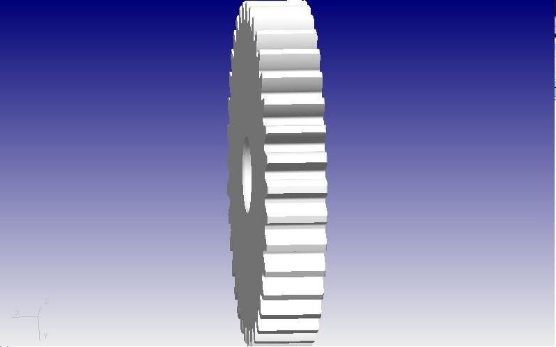

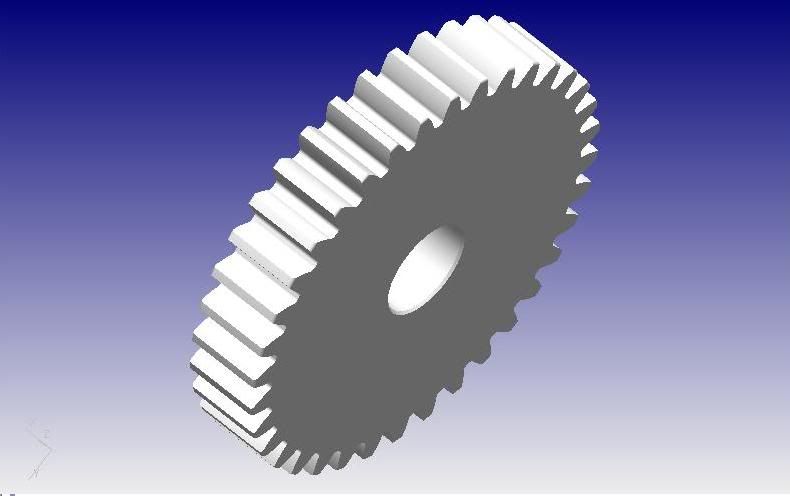

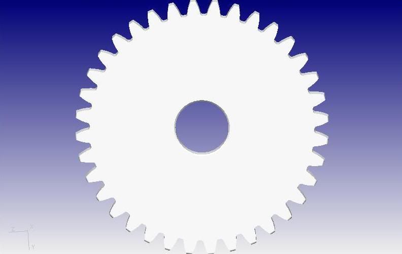

here is what i have decided to do. i ordered this spur gear in 37t. (a 43t is also avail.) it looks to be the easiest one to modify. all i will have to do is bore out the middle to 12mm and drill 4 holes to screw it down. i think it will work. if it does work i will can order the 43t and do the same to adjust gearing if needed. but i want a fast ride so i am starting with the 37t and see what happens.

Ok, had a look for a 12mm bore, hubless, mod1.5 steel gear. Came up with this:
https://sdp-si.com/eStore/PartDetail...70&GroupID=591
Here is the pdf info on the gear familar, just look at the 36t hubless info in the 1st table.
https://sdp-si.com/eStore/..%5Css%5CPDF%5C78501072.pdf
At 22 bucks plus shipping it is not too bad. Diameter is 57mm on the 36t gear, so not sure if it is too big to fit with the stock center bulkheads...
If those links do not work, search sdp si on google, and put this part number in their search feature: A 1C 1MYK15036
