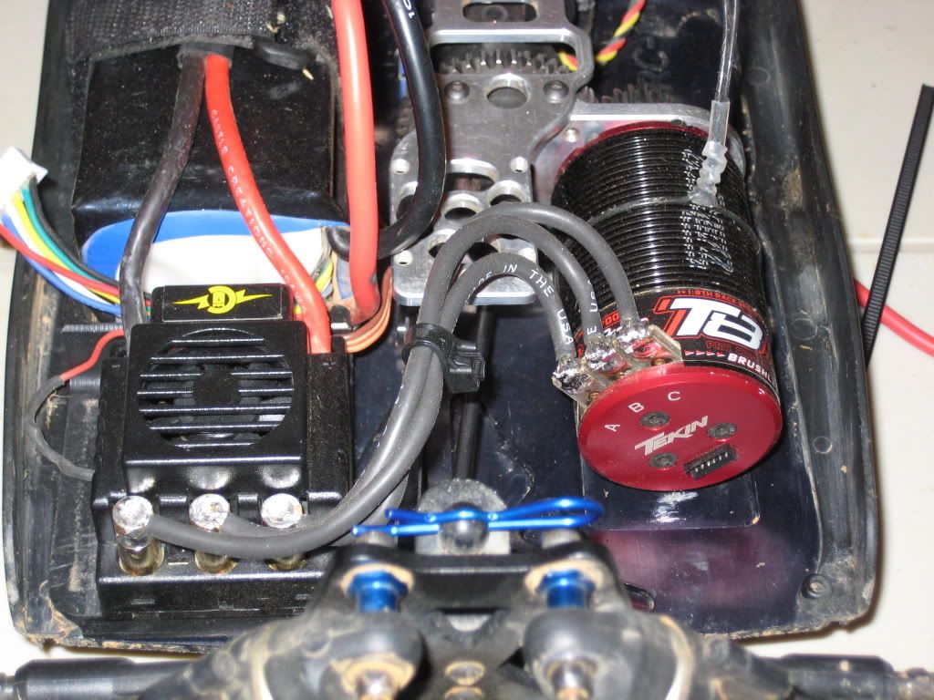

Haven't done much lately with my buggy due to my air plane project. I wasn't feeling too great today so I took the time to sit down at the work table and resolder my bullet connectors so that the wires wouldn't rub against the body.
Not much change, but it's a nice fix.

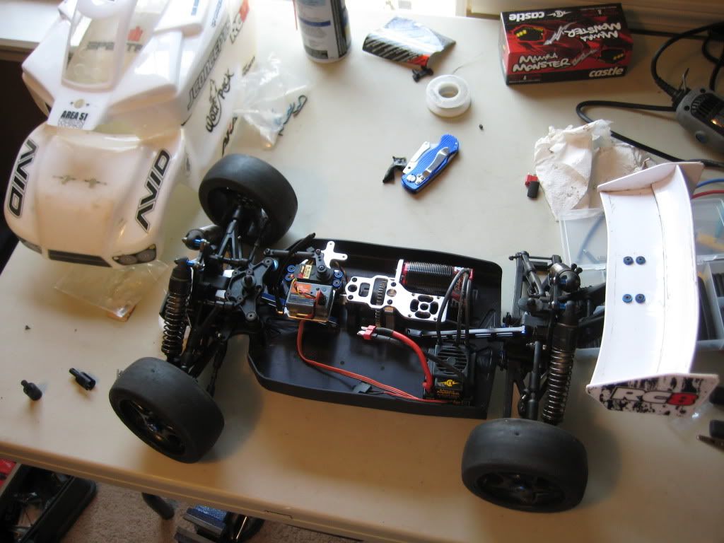

  (#41)
gholt13
01.25.2010, 05:01 PM
Originally Posted by Snipin_Willy View Post
Got one of my goodies in. Tekin motor came in yesterday and had the time to solder some wires and plugs this morning. I'm an thrilled with the quality of the motor. Yes the buggy is missing a rear hub carrier. I salvaged it for my RC8T because I broke one yesterday. Truggy has priority.
Edit: helps if I post the pic
were did you get center diff top plate from i cant find it
