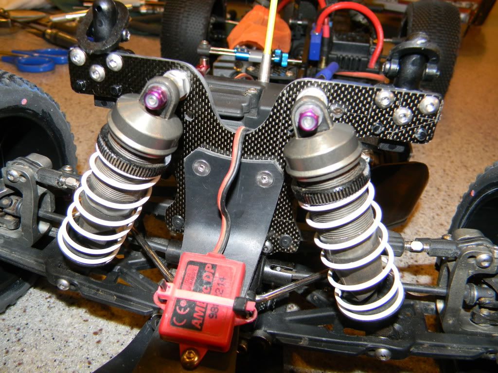

Been almost four months since I updated this post. Lots of upgrades and fine tuning since then. Current setup, MMP, Novak HV 4.5, Elite shock towers, Elite low CoG motor mount, 1/8 Z-car shocks, STRC servo saver, Ofna PBS suspension, T-Bone front bumper.
MMP and Novak HV 4.5
PBS suspension
Ofna optional captured steering links
Elite extended shock towers.
