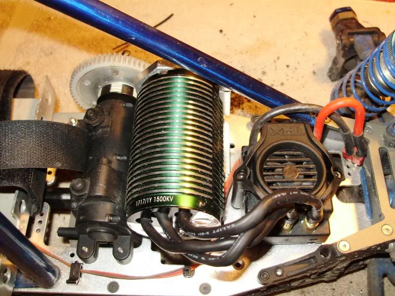

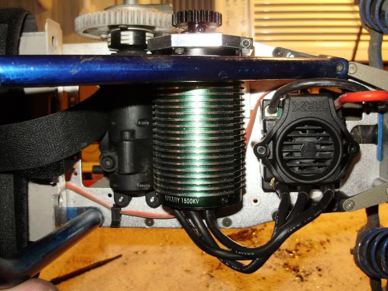

Received my 5mm rotor last week and got around to doing the install last night and today. I drilled the 3mm Dude mount out to 11/64 and the motor bolted right up no probs. My diffs were recently rebuilt with Nova cups and Muggy gearing so I need to crack them back open and swap out the ring and pinion back to LST. I replacd the gear that gets the most punishment in the tranny and did the gear swap for the higher final ratio while I was in there.

After I rebuild the diffs, seal the where the wires come out the can and get the tires mounted I bought from Nitrostarter (Thanks Cory !) I will post more with pictures and test results.
