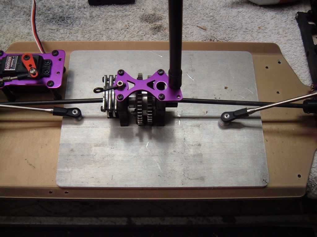

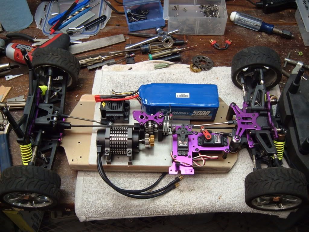

Some pics:

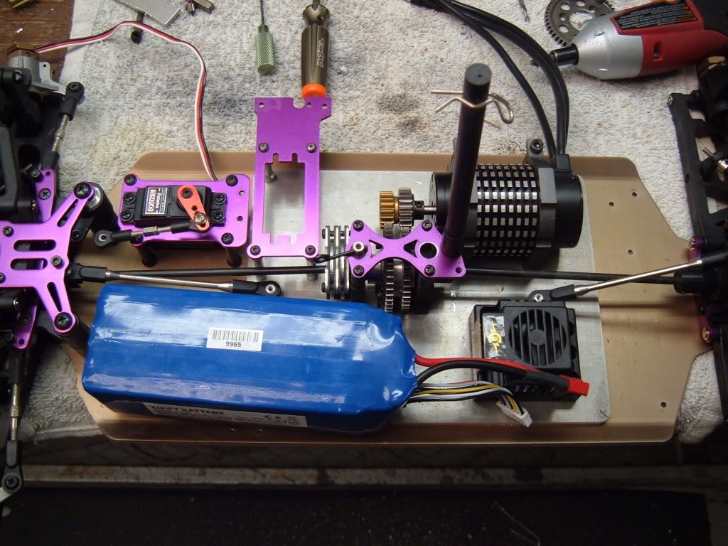

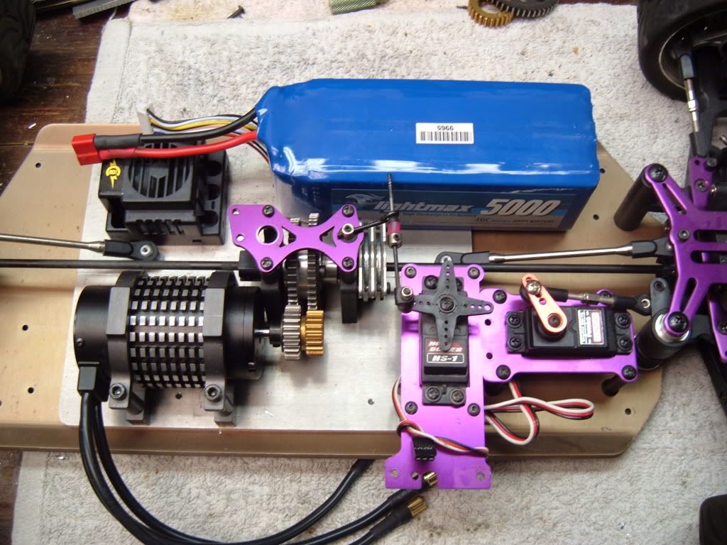

Got some more work done. Drilled and tapped 4 holes to mount the plate to the chassis, thru existing holes. Also mounted the brake servo mount to the plate, used coutersunk screws so the plate sits flush on the chassis.
Waiting on gears so I can mock up the motor clamps and drill holes for them. Will make a battery tray and trim the brake servo plate as my bandsaw tires just arrived (yay). Need to wire up the MMM and make a mount for the receiver, pretty sure I will put it next to the steering servo. Then I get to attemot to remember how to program the M11 to slave the brake servo on ch4... Sounds like alot of fun.

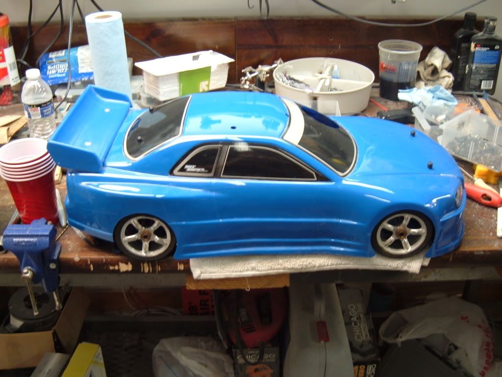

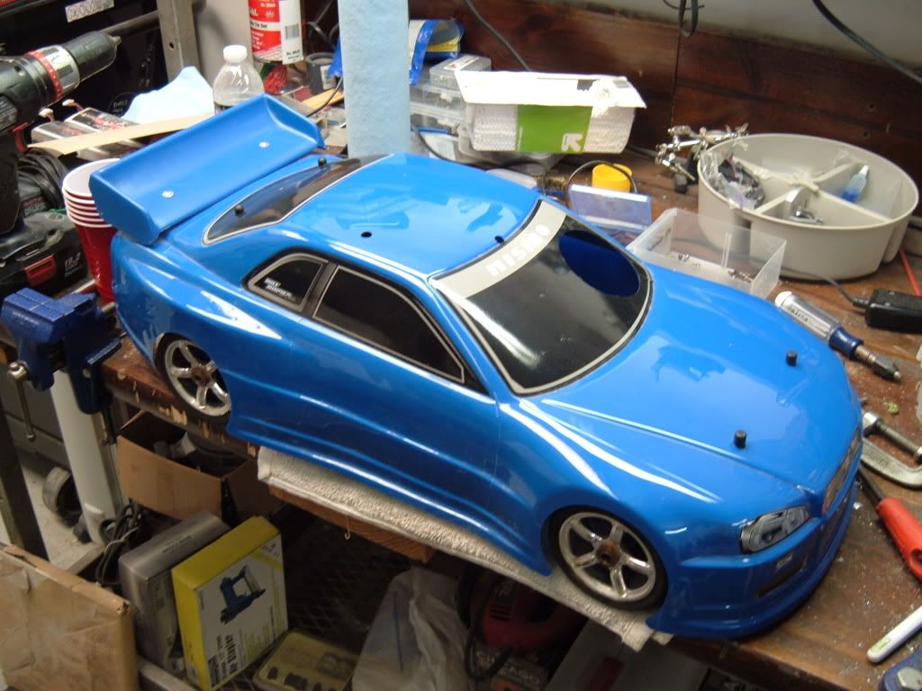

Here are a few pics with the tires and body on.

Looks nice but ESC looks "FET" challenged... Some new super light MMM design?
PS you need to shorten your steering link.

HAHA, yeah, the Lite version 1!!!
The steering link is the correct length, just not attached right now. Not sure if I will continue to run that servo, but I may as I will be running a ccbec and will crank the voltage to 6.5v or so. Not the best servos but I have a bunch and they are fast, reasonably torquey, and have metal gears. Plus they were free.
