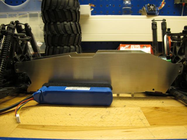

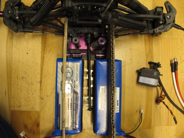

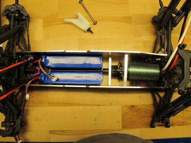

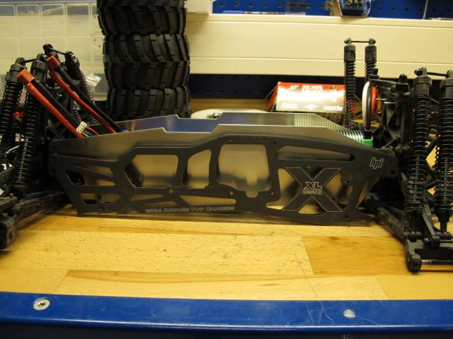

Motor mount under way... still need some support between the two parts :)
Alza racing delivers:
Hmm... with a skid plate and some sort of dogbone protection the batteries could be squeezed in between the TVPs. Motor mount was made with a centered 1717 since this allow me to push it further back.
On the other hand... a wide skidplate and a cut out in the bottom of the TVPs = batteries mounted low and horizontal:

Where will the steering servo go with the batteries up front?
Interesting idea about the cutout in the bottom of the TVPs. If the batteries were up front they shouldn't cop much abuse there. I've been toying with the idea of mounting a battery sideways above the center driveshaft. Could move it back and forth to tune the balance as there would be plenty of space.
  (#34)
Nixpus
Posts: 138
Join Date: May 2009
Location: Denmark
03.22.2011, 05:21 AM
With the batteries "inside" I'd have to make a cut out in one of the TVPs, flip the steering arm 180° and mount the servo on the outside.
Its safe to say im leaning more towards the cut out approach... especially after I got the solid TVPs from Alza :)

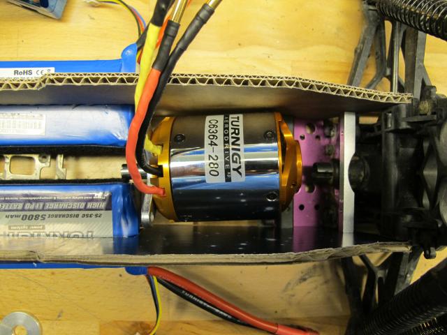

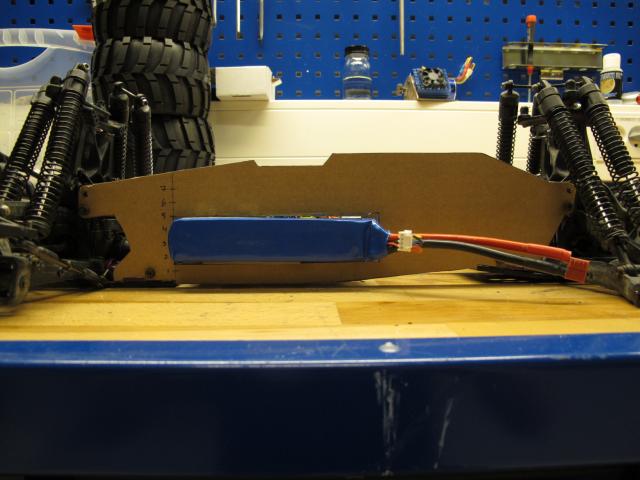

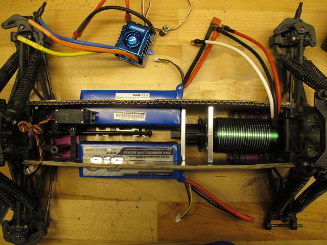

A little prototyping progress...
Cardboard TVPs with cut outs and batteries:
I need some sort of end stop on both sides of the dogbone. There must be a U profile with the right dimensions somewhere!
Servo can sit in its normal spot (more or less):
Battery placement in relation to the dogbone (vertically):
Ive got 1cm of 3mm thick alu on the bottom side of the TVP cut out at each end of the battery as it is. I wonder if its safe to go even lower? Damn I should have taken the 5mm TVPs!
If I could go lower it would help servo mounting... still for my friends inrunner project we need a different servo placement anyway. Bright ideas are welcome :)

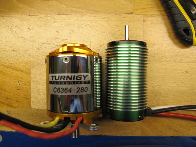

Because this is the stuff we need to fit into the construction:
The fat outrunner:
9 LiPo cells (its not the packs we'll use but you get the idea):
Its slightly crowded at the backend where I have CD and 1717:
We'll most likely have to do a cut out in the "bulkhead plate" otherwise the angle between the drive cups will be extreme... more fun challenges :)

I was planning on doing my 5T plates with the batteries cut out in a similiar fashion. My biggest concern was protecting the batteries from damage on the sides.
As for the 1cm... if you have a bottom plate that ties together the sides underneath the batteries, that should make up for any weakness in the TVP itself.

And I also wonder if it matters a whole lot if the 1 cm of material is moved up above the batteries and then the battery bay is inserted as a skidplate?

Probably not. If you look at my thread thats exactly what I had arrived at as a plan of action.. at least until I decided to switch gears and just use a truggy as the base platform (trying to turn a savage into a truggy and then into a 5th scale buggy seemed to be a lot of unnecessary work).

That's a darn big motor.

You are going from an already overkill 1717 to an out runner? what sort of specs is it? kv? max rpm or lipo cells? It is HUGE! will you need a new centre diff setup?
