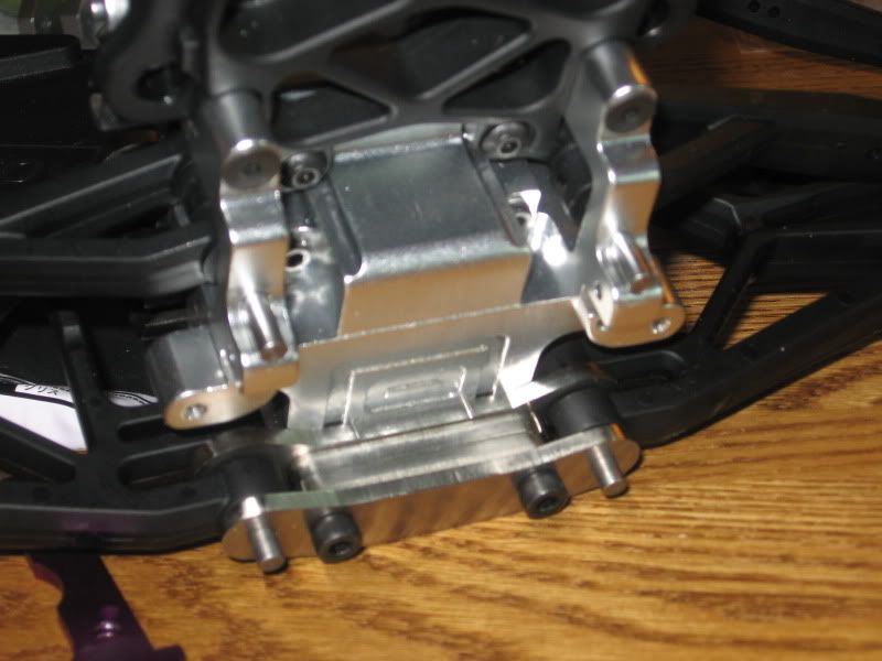

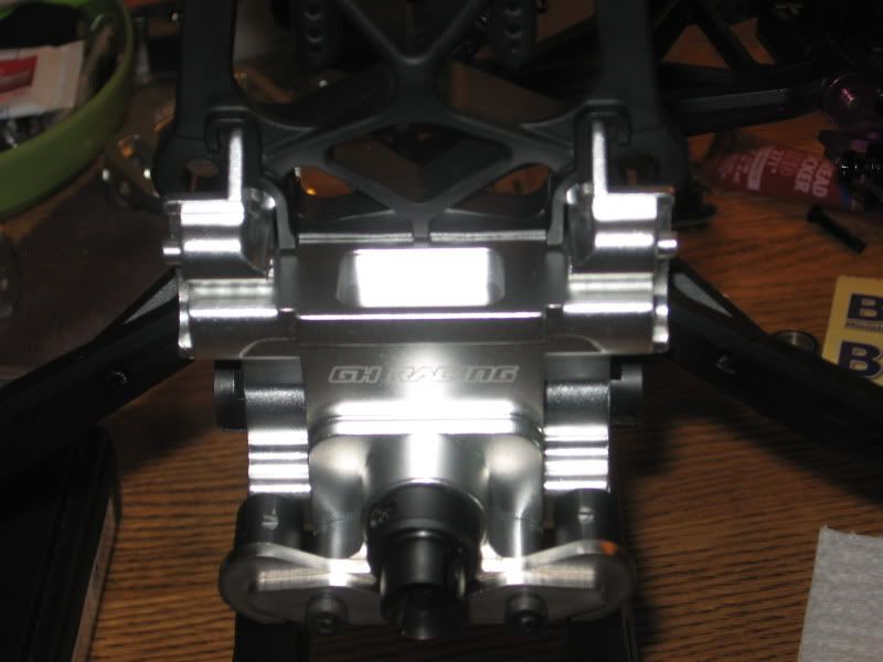

Here ya go...

oooh shiny, can't stop staring.
are these aluminum bulks quick access like the x bulkheads?

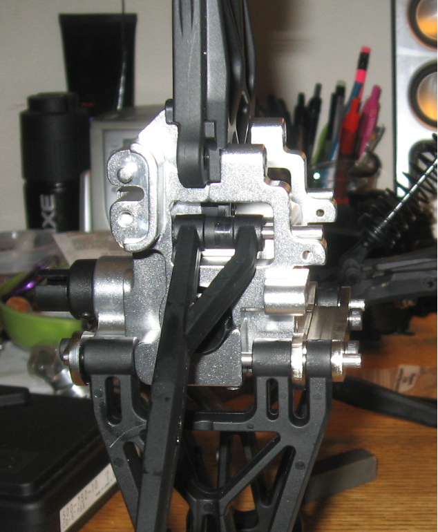

They have a front and back case like the quick access bulks but Im not sure if the front case comes out exactly the same as stock.
Im kinda doing a mock-up build right now just to make sure everything fits right and i know the correct order to put everything together in.
Then im gonna tear it all down to grease stuff, threadlock metal on metal and CA metal on plastic as i build it again from the ground up.
I can let you know how much of a pain they are to take out when i tear it down but I dunno when that will be exactly. Hopefuly another GH aluminum bulk user will chime in with an answer for ya.
02.18.2011, 10:47 PM
Not quite as easy to get into as the X bulks. You have to remove the pin brace bolts on the bumper side, remove the 2 bolts that hold on the plastic skid plate closest to the bumper, remove the shock tower bolts and the 2 smaller ones below them. I like to pull the upper arm pins out.
These are sturdy parts, iff you shim the diffs correctly the only reason you will have to remove them is to change diff fluid.

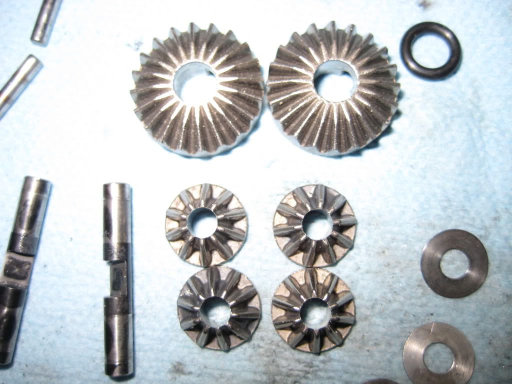

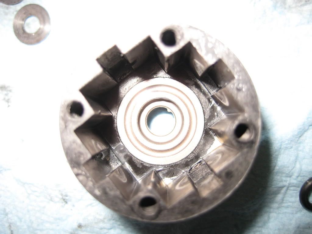

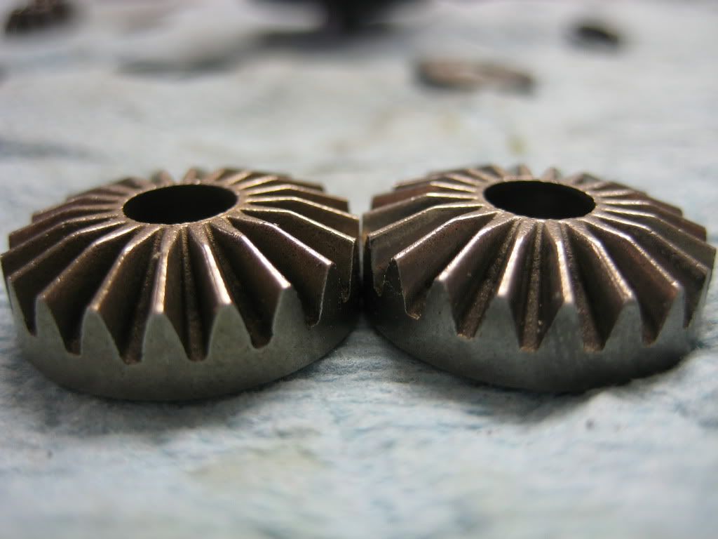

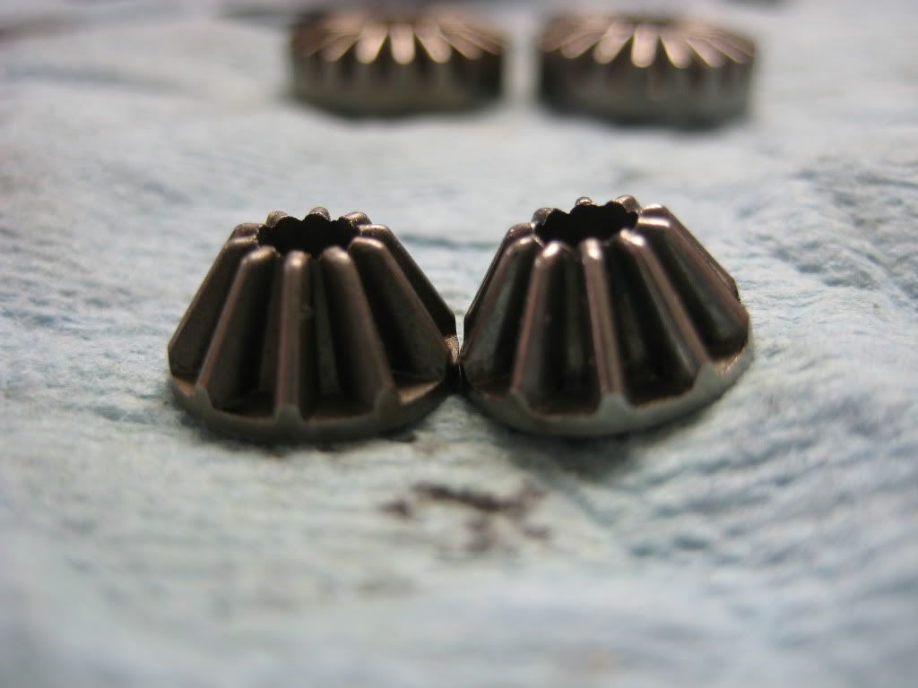

Up to about 30 runs now on the Vorza cups. I noticed the ring gear side bearing had some lateral play between the inner and outer sleeves on the front diff, so I swapped it out. While I was in there I decided to degrease the internals and give them a close inspection. I compared the used internals to some new ones and there was no discernible difference, even at the highest magnification my camera would allow. Guess that lithium grease works WELL!
There was a very slight amount of scoring inside the cup from the spider gear shims spinning, but not enough to warrant replacing the cup. I also noticed a small chip in one of the slots (probably from an air bubble getting into the mold during manufacturing. Just for kicks I replaced the grease with some STP Oil Treatment before I sealed it back up . . . curious how that will do.
Gear on Left is new, gear on right has ~30 runs
Final Update till something breaks

Took the rear diffs apart, and they are in excellent condition as well. Only difference, is no small chip in the slot.
Went ahead and replaced the grease with STP Oil Treatment in these as well.

thanks for the detailed images Jason!!!
Gives me a lot more confidence that they will hold up to the 9s power in my alloy bulks!
So surprised that there seems like there is no wear...
I guess if it all works correctly and installed properly, there really shouldnt be any serious wear

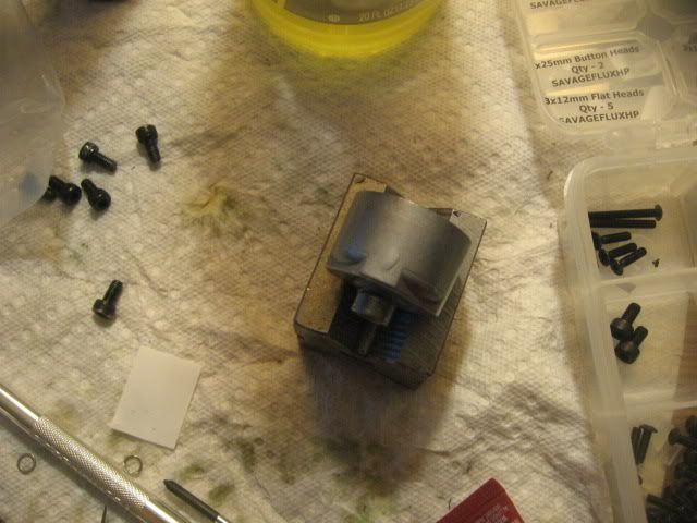

I recently tore my diffs apart again and filled the rear/front with 30k/50k about 3/4 full in the diff cup. Then put a nice glob of STP oil treatment in them to fill up the the rest of the space. This stuff is a lot thicker/goopier than i thought. Hopefully it treats the gears well!
I was tightening one of the diffs when near the end i heard a little crack.. My torque-o-meter tells me I wasnt using excessive force.. The stock cup is just straight up weak and made out of soft material.. (aluminum is soft in general but HPI's is like butter) So needless to say, there goes my extra diff cup I had on hand. Will be purchasing the Vorza cups very soon.

ljoncp, The stock spider gears, cross pins, shims, etc. are a direct drop in. The Vorza cups are actually a hair smaller inside than the stock cups, so you may need to sand a few thousands off the length of the cross pins. Do a test fit first ofcoarse.
