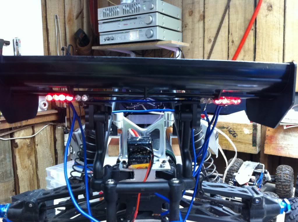

Just for some fun i thought i would put some brake lights on the under side of the wing.
