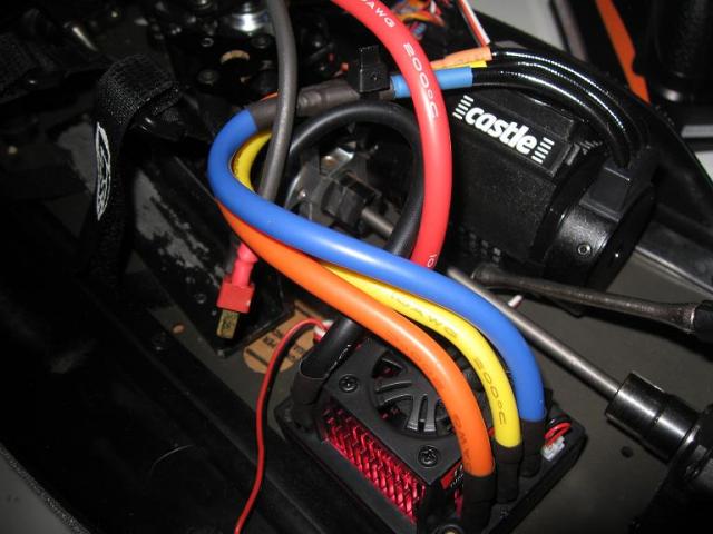

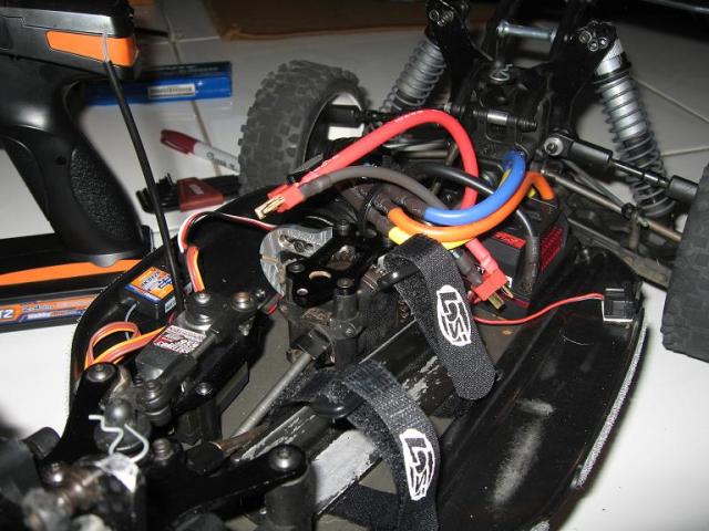

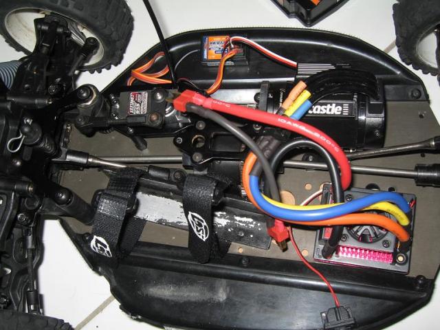

well heres some pics of the electronics setup! let me know what you think! well if i get bored with this car and when i have some money i will do a build but make it into a race buggy like have 2x2s each side of the chassis and the esc somewhere and might try and put the motor facing forwards! that might be a while though

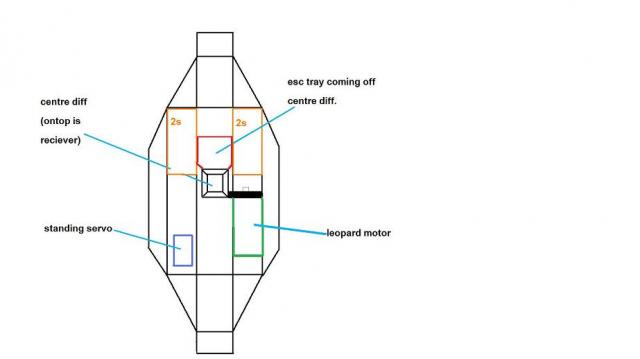

well heres a quick drawing of wat i mean of the chassis racing design

Aussie Nerd
02.19.2011, 11:12 PM
Leave it how it is, the RCM mount was made to put the motor out the side for a reason. Oh and wiring thanks to me
Kieren
  (#38)
bundyracer1
02.19.2011, 11:18 PM
wat lol im not changing the motor mount i was thinking of just turning the whole centre diff but i dont think it will work anyway my motors long. yeah kieren did all the wiring

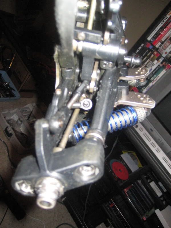

bundyracer1, ok here are pics:
I want a motor mount soon. Also some of the plastic bits have a little play so might just replace them, or just bash until something breaks For now just gotta clean up a little.
I have the diff flipped around like that in my Jammin. Yes, the longer length 70-75mm motors are too long, you would need a more typical "buggy" sized motor, like 60-65mm. Aside from that you might need to put shims under the center diff mounts to add some clearance, as the spur will no longer be over the clearance hole cut in the chassis.
Honestly, I can't say how this setup compares to a single pack setup like you have it now, because both my buggy and truggy have always been saddle pack with the diff flipped around. But I have noticed a lot more vehicles using this setup now (Nexx8, Durango, Caster, HHH chassis for Hotbodies)

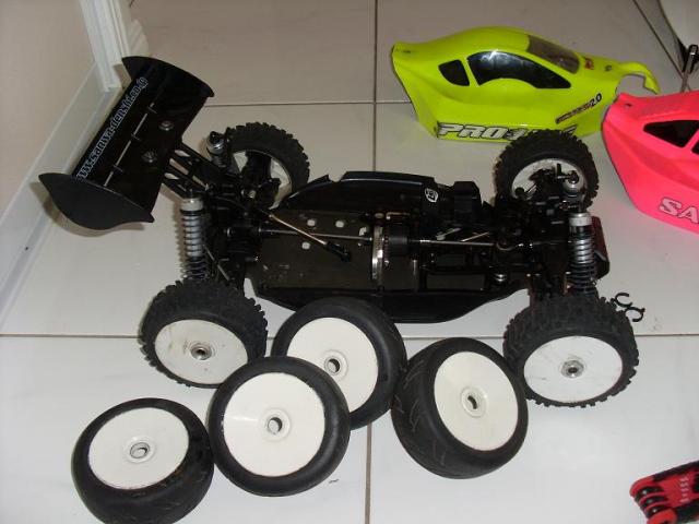

  (#44)
bundyracer1
1/8 offroad and onroad for sale - 02.28.2011, 02:23 AM
hi,
ok i am going to sell these cause they aren't needed anymore!
onroad wheels-$40 shipped ono
offroad wheels-$30 shipped ono
if anyone is interested pm me i will only ship to aus not america
thanks Braden
Name:	new hyper 001.jpg
