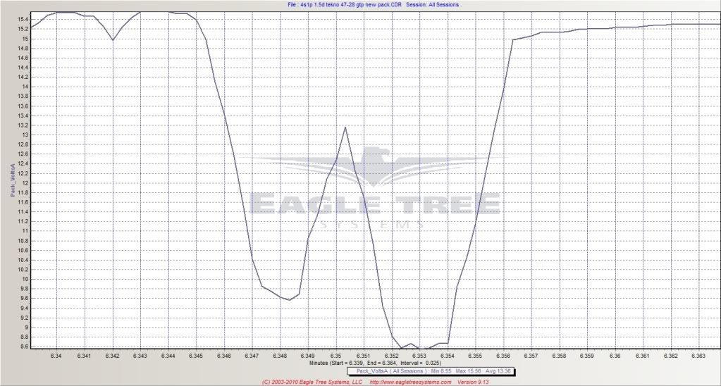

The 50hz will let you capture higher watt+amp peaks and voltage dips. I was able to see the Acepow pack drop to 8 something volt under load for 0.002 of second. This was enough to disable the RX8 ESC as the voltage cutoff was enabled. I wasn't able to see this with my older 10hz version.

Are you sure that was 0.002 seconds? 50Hz equates to 20ms (0.02 seconds). Even still, that's still 5X better than 100ms.
asheck: Just be aware that setting it to 50Hz will reduce the amount of time you can capture data, and it also depends on what data you are capturing. If you just capture battery voltage and current, you might be able to last a whole run, but if you also capture other things (temperature, rpm, etc), your capture time will be shorter.

Don't worry about the 50hz. The logger has more memory and its recording algorithm is changed. I use the brushless sensor, temp sensor and gps for a whole pack and still have space after a pack.

Hmm, nice! I might have to get me one of those and sell my older 150A version. I really wish the onboard current sensor would measure accurately up to 300A though to catch those instantaneous peaks...

Yea me too. Because it would be nice to really know the true amps I was pulling for the Voltage to drop to 8.55. I use my older one for "light" duty now. I stuck Deans to it and use it for my older FMA charger, and less powerfull toys.
