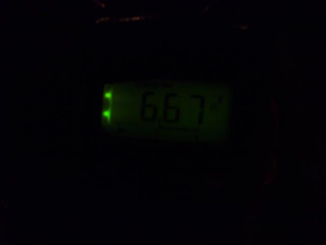

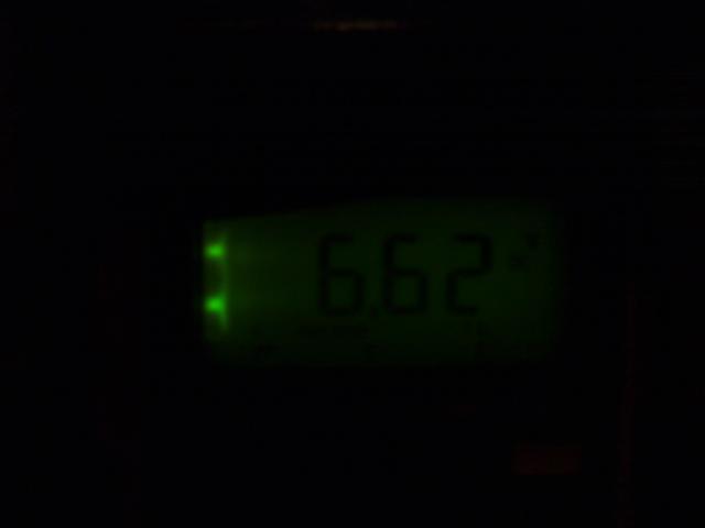

Ok so I figured I would give it a try. My setup doesn't lend itself to this type of testing, but it at least shows that it does work.
I used my Rustler running a MMM and a Fine Design 6 turn slotless 2 pole motor, 2S2P A123 battery. Braking isn't very good, and the added weight of the DMM didn't help. The meter I use is a Fluke 112 DMM. The battery pack was not fully charged it was as I pulled it from the drawer.
