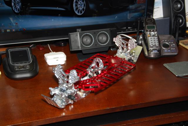

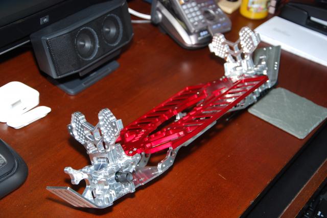

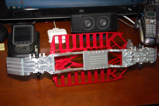

a few more pics

So i received the new upper bracket for the cd mount today. I also got the 46t spur gear. I was hopping that the smaller gear would fit between the opening on the frame. No such luck. I guess I will have to do some work with the Dremel, unless there is another way. I can't be the first to try to fit a Slipperential to the extended FLM Maxx? Are there pictures of it mounted without having to hack the frame? I don't have a problem doing it, but if I have other options I will try them first.
  (#37)
07.09.2011, 04:21 PM
The trouble is the new emaxx tranny is narrower than the old one, so the chassis rails are closer together as such- was never much of an issue on the older style FLM chassis for the 3906 tranny, but with the new chassis you don't have any option besides notching the chassis rails either for the spur to fit. On the upside, it should be very easy to do a neat job- just hacksaw or dremel the notches and then clean them up with a small flat or square file.

Rebuilt the slipper with the 46 tooth spur, notched the chassis, and everything fit perfectly. I need to drill the holes and mount the slipper next. Then I need to figure out how long the dog bones need to be. Neil do you or anyone else know how much Mike charges to make custom dog bones?
