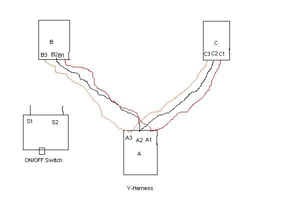

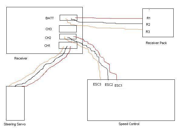

Regarding the y-harness, I'm more of a visual guy and your description doesn't really end up making sense to me. I'm going to attach a drawing I just did at my desk here, and one of a y-harness in the next post. I labelled everything, so if you could help with what goes where (i.e. A1 goes to B2, etc...) I'd greatly appreciate it. If it works out, you could even use my crude drawings as a how-to somewhere else in the forum/site.

Y-Harness.
Note that wire 1 is red, 2 is black, 3 is orange. I don't remember if I got them in the right order, but it's the color that's important, so I hope it's good enough to work with.

It is much easier than you diagram makes it out to be. There is a thing called a y harness. All it is a receptacle for two servo leads on one end, with a servo plug on th other. You plug both items that you want to run from the same channel in the receptacle, and plug the servo plug into the receiver. In your case, you would plug the esc and receiver pack into the receptacle, and plug the servo lead of the y harness into the switch and plug the switch into the channel two section of the receiver.

Yep - I'm familiar with a y-harness...that's what the second diagram is ;)
I guess my confusion is from two things;
1 - Can you plug both the ESC and the receiver pack into CH2 on the receiver? I always assumed that the receiver pack HAD to be in the slot specifically designated for it on the receiver.
2 - I have a switch that came with a previous radio, and I tried to put it in-line with the ESC early on. Steering didn't work, only the throttle worked, and I assumed it was because the switch only has the red and black wires, and no third wire. I guess I'm looking for a switch now that has all three wires.
All that in mind, I think what you're telling me (based on my drawings) is that I need to plug my receiver pack into "B" on the harness, and my ESC into "C" on the harness. Then plug "A" into an on/off switch and plug the other end of the switch into CH2 on my receiver. Is this right?
I'm sure what you said in the last reply is right - I'm making it more difficult than it needs to be :)

"All that in mind, I think what you're telling me (based on my drawings) is that I need to plug my receiver pack into "B" on the harness, and my ESC into "C" on the harness. Then plug "A" into an on/off switch and plug the other end of the switch into CH2 on my receiver. Is this right?"
Yes. You do understand. You will need a switch harness with three wires(most times, there is a receiver pack OR BEC, (not both), which makes your setup a little different. The receiver pack can be plugged into any channel in the receiver. In fact, sometimes the servos work better when the receiver pack is plugged into another channel (not "bat" slot), as some receivers limit output voltage to 4.8 volts when using the "bat" slot.

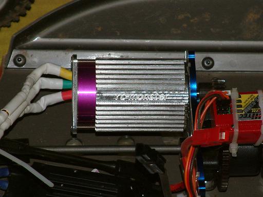

Mike - here's a picture of the motor clamp/heatsink mounted. By the way, it takes a fair bit of effort to take a decent picture of it using a flash since it's so shiny. :)

Yes, I had quite a bit of trouble getting a decent picture as well, due to the shine.

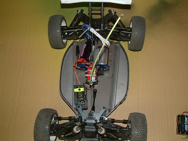

I got to run one pack through the buggy a few minutes ago. I'm still working on the solution to hold the batteries in, but I'm hoping I may have something worked out in the next couple days.
I did work with the brake exp. on my M8 and was able to dial in a good amount of brakes. It still doesn't have "super-brakes", but it's more than adequate for stopping the buggy quick. I'll be trying out between 75% and 100% at my local track (which we're building now) to see where to sweet spot is.
My wife was sitting with me when I ran the pack in the car and one of her first comments was "we need a bigger yard, don't we?". :)
I love my wife :)
Thanks for the idea on checking the brake exp., Mike. I did try good batteries, but they didn't seem to make any difference.
Attached is a pic of the overhead view.

I am glad you got some brake action. i don't like my brakes to lock up, but I do like to be able to slow down! So, is the wife working on that bigger yard for you!?
