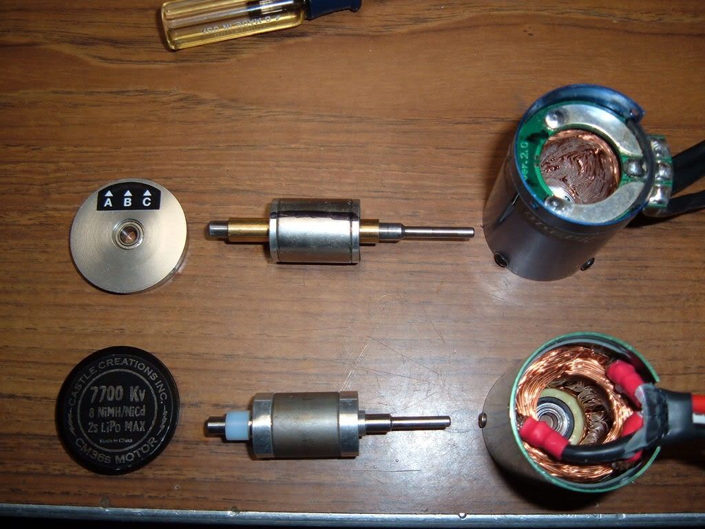

Heres a few shots inside the traxxas motor and a mm motor:
Note the difference in rotor construction and spacer usage. The cc motor is not a feiago, where the traxxas looks just like a feiago, save for the solder plate. Now the recently released sensored feigao motors have a solder plate.
After all of this we are debating a 10th scale 2wd motor. The motor is designed to be used that way. You will not get 40+mph out of this motor in a heavy vehicle, not going to happen. Tons of heat and lots of draw thru the esc.
