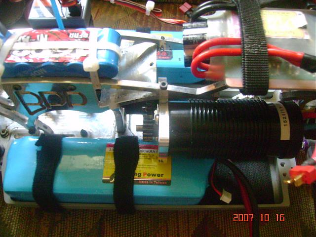

I got a concern. Is the savage going to have the room for the 1521 neu in the spot you going to mount it.
It does have limits if you put the motor in some spots. Just like to add that. :)
