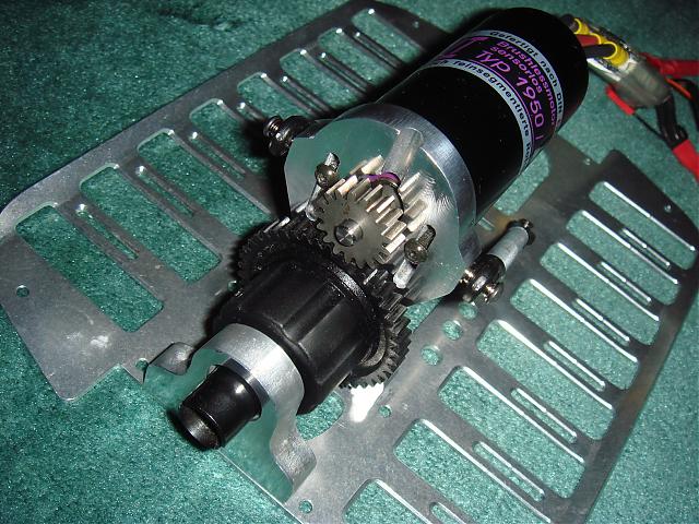

Ummm.....you know, guys, I have a slipperential in my SuperMaxx, but I want to taste my Maxx with a centerdiff. I've been looking around for someone to make me a nice centerdiff mount with drive shafts, but no luck.
This one is made by Mike a very long time ago, and it has a few flaws that holds me from using it. It's evident that his work on the slipperential is lightyears ahead of his work on this thing.
I hope you can hear me, Mike. I want a damn centerdiff for the SuperMaxx ( with slipperential quality).

Here! Here! I am waiting for my direct drive units too! And I am in the process of building an e-revo on a gorillamaxx chassis...so I will take one of those damn slipperential things too!
