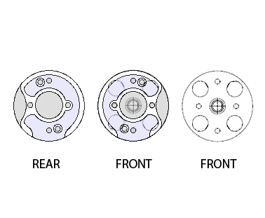

12.24.2008, 07:14 AM
How does Medusa work when those cooling holes are covered, as it cant cool down?
Im working on brake-adapter that has cooling channels in it, and it takes air in one specific place, that can be protected from dirt and dust. And for rear im planning "airfilter".
But havent got my motor yet.
e. I could just share my sketch, here.

The Medusa Motors were designed with Heli and Airplane Applications in mind.
When used in a Monster Truck or Land Vehicles, very little air goes through there anyway.
Inside the motor, the windings where the heat is generated, is in direct contact with the inside of the motor can.
Just a regular heat sink will work just fine, even with the holes covered. As long as your setup is geared right.

They work just like a normal motor when the holes are covered up. In an airplane there would be a prop in front of the motor and that would blast air straight through the motor. They run VERY cool in an airplane as you can imagine.
