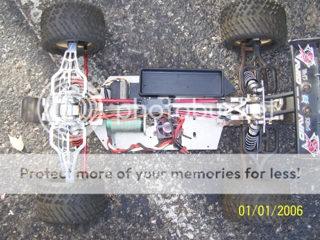

Thanks Alien. I am excited to try it out and enjoy it.
I don't know where else to put it. It is a huge battery. lol Yeah I'm thinking it should provide for a good balance remember the monoblock.

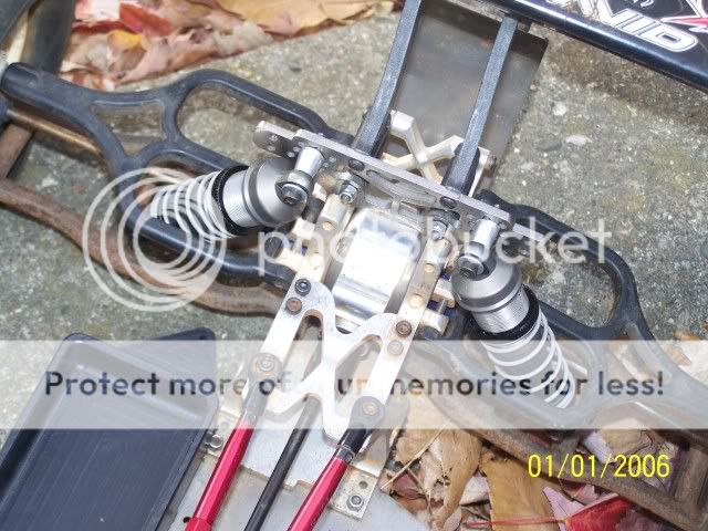

Looks good! Hows the suspension travel?
JoFreak
JoFreak's Avatar
Posts: 447
Location: Munich
11.02.2010, 05:52 PM

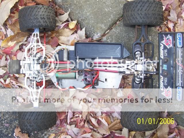

I really like what you made out of that truck!
But I too have problems imagining that the balance would be too great with the battery so far off center.
The mono block isn't going to help with that.
I would flip the diff arround, put the ESC behind the motor and place the battery on the side where the motor is at the moment.
But then: I haven't seen your truck in action nor have I driven it, so I have no idea if the handling actually is influenced in a bad way by that weight distribution.

I would have to agree only because it looks as though your diff is barely offset to on side. That is the way my 8ight is setup and I think the balance is pretty good...

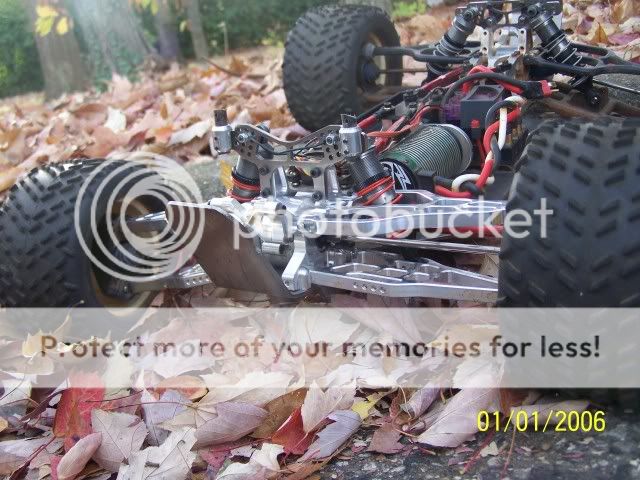

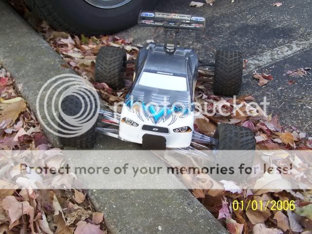

But it looks Great! I love that chassis! I really wanted to go that route with my maxx... Got a side shot? I bet the body sits LOOOW with those Towers!

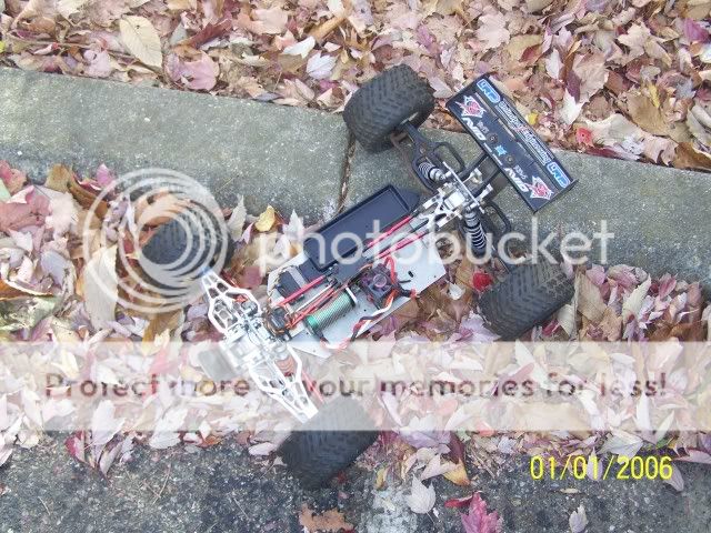

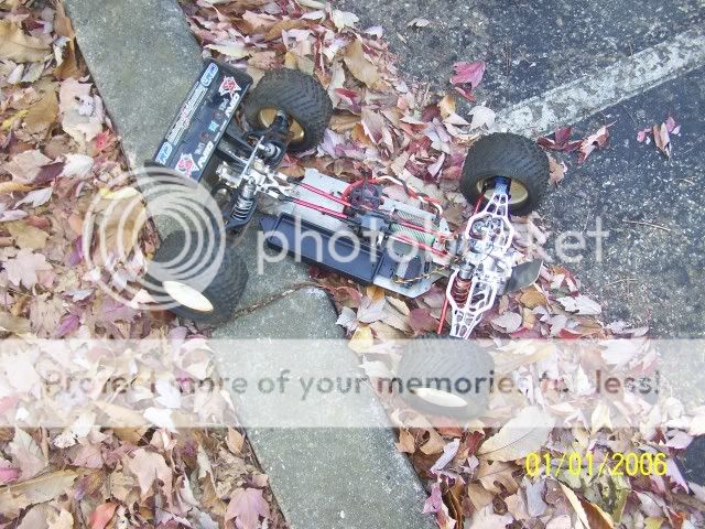

Oh man! I can't wait to get some video! Tomorrow perhaps. She is bad fast! I mounted the body by cutting slots in the body near(above) the Duh towers and ran Velcro straps through the slots. It works great! And no more clips! Now I just wish I would have done it this way to begin with.
I ran the truck for about 15 mins today and it couldn't have gone much better. Everything works great and the truck turns on a dime. I couldn't make it flip despite every effort. So the battery tray location has no negative effects so far on handling. It will be 3 weeks before I am able to test it mid air. I'll have new springs at that point.

Thanks guys! I got the towers from user and community member Rivermaxx. Great guy. Has ran some good trucks. No they haven't been made in years and are hard to come by. Funny thing though. When I bought mine there was a set on Ebay. First set I've seen on the bay. I have wanted some for a whole year before I had the opportunity. Thanks River. They do rock yeah. There are some other short towers. Duh, Nova, GMaxx and one other... Can't remember. Why do you want a set?
I am using UE outdrives with TRX shafts. Great combination. Just watch how high you jack the truck especially with RPM TrueTrac. If the dog bone end comes out and can't get back in bad things happen while in motion.

I have noticed that when I really get on it while turning away from the battery side the truck gets less turn. So it does have some effect while on the ground.

Its not like that. The weight of the battery is what is causing it. It turns great at all speeds but you can tell it takes alittle longer for the whole truck to change direction because the battery on the one side when going really fast. I may not be making any sense. It really is a mute issue the problem may pronounce its self while in flight though. We'll see.

I'm using the UE outdrives that are attached inside the diff. Its the small cup 6mm instead of 8mm I think. It fits the Trx shafts no like a glove. What I explained to you is correct. People say it doesn't work because they jack it up and it bends. You get plenty of travel still just be careful. Nice, Flextek.
