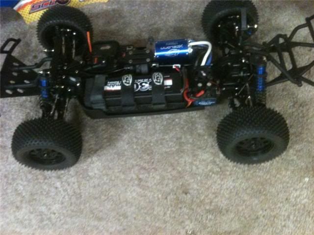

You mean these:) I asked Casey on the losi forums how he managed the wheelbase. He said he flipped the rear arms left to right and did a little dremel work, got 23mm longer out of it, but you loose the droop screws.
He also said that the best way in the future will be a proper chassis.
What bumpers are those and what did you do to your truck... I need info good info so I dont go the wrong way! Help a brother out! Thanks for posting pics... is this the RC Monster conversuin kit?

He used an 8ight conversion. Mikes RCM conversion is much nicer and durable,and cooler looking!!!!!!!

I would also like to know what bumpers those are. They look like Traxxas, but looking at amain's website I don't see them under Slash, Slash 4x4 or Slayer.
I flipped my arms, but instead of mounting the shocks they way he did it, I mounted them to the front side of the tower and stock position on the arms. The wheel base is now there, thinking either ProTrac wheels or m2c 17mm hex adapters.
Also the Slash 4x4 front bumper pretty much mounts right up.
What would be cool would be if you could post the link to that build from the Losi forum, because I can't find it on there anywhere.

Nice job on the back end... shocks look like they are perfect. Now... can the droop screw be re drilled and taped? More guys more! Mine is here in 5 days...
think im going with 18t pinion to work with the R1 448 motor combo i already have. Then its the new Tekin SCT motor for me when they come out. M2C 17mm wheel adaptors and some prolines....
