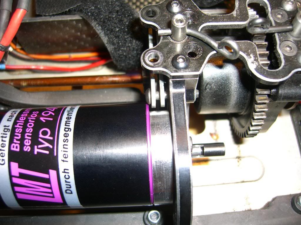

Here are a couple pictures of it and pictures of it installed on my buggy. Works perfect for me.
I installed it on a Neu at first, then I changed my mind and used a Lehner so thats why different motors in the pictures.
If you send Mike a note I'm sure he made a few extras.

Thats a cool little part to allow mechanical brakes. I'm just afraid that the shaft wouldn't stick out far enough for the pinion gear...
  (#49)
jhautz
jhautz's Avatar
Posts: 4,217
Location: Chicago, IL
04.08.2008, 12:28 AM
With the Neu motors there is no problem at all, they have unusually long shafts. The Lehners and Feigaos are starting to get to the end of the shaft, but its no problem. The shaft on my 1940 doesn't quite stick out the other side of the pinion gear, but it in there plenty that there should be no problem.

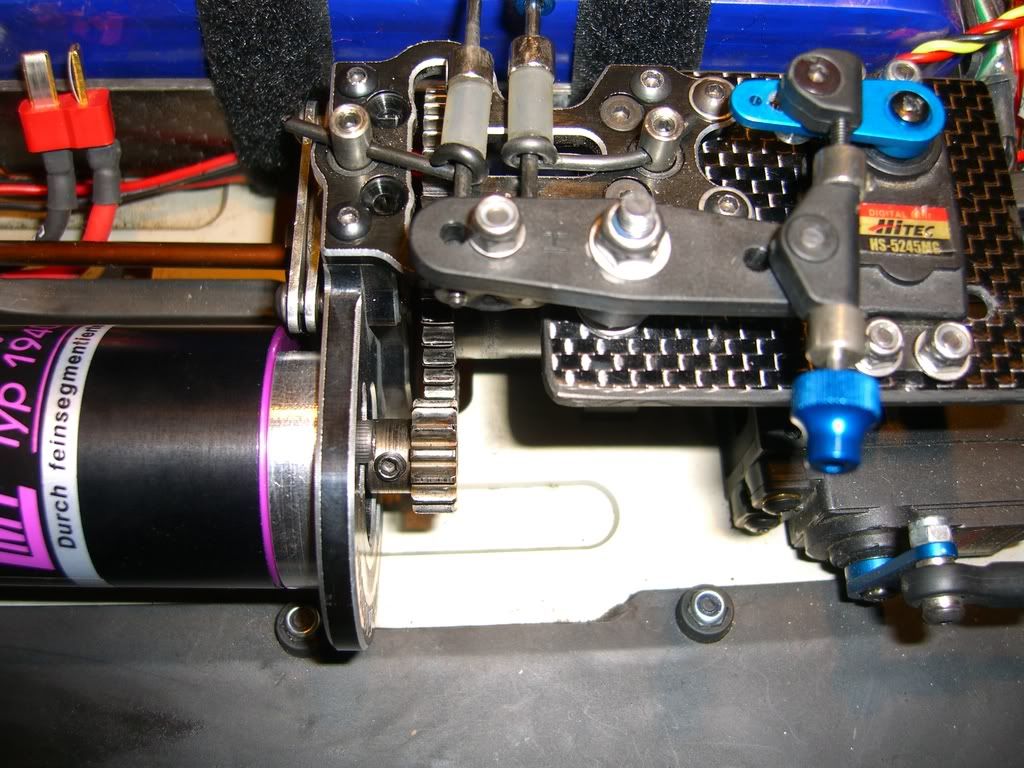

I have the CD flipped around cuz I was running the Tekno CLutch in that buggy. I actually just got done flipping it back around to get rid of the clutch and reinstalling the mechanincal brake servos and linkage. Heres a picture on it finished and the dif flipped back around the right way.

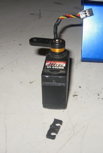

I was out for some practice when I noticed I suddenly had no brakes. Checked the buggy and found the horn had sheared off the servo. Hitec Karbonite gear broke in half.
