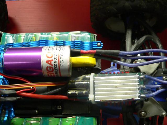

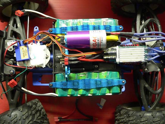

evader
07.02.2008, 11:31 PM
Ok, so I figured out that it wouldn't program until I reversed the direction of the throttle on my radio. So now it will go through all the steps of programming...however it keeps going through those steps now. What I mean is even if I don't take the "little red jumper" off to program it it is always in the programming mode (even when the "little red jumper" is still on). What the heck is going on??? Am I missing something?
Here's some pictures.

  (#51)
GriffinRU
Posts: 748
Join Date: Oct 2005
07.03.2008, 07:36 AM
Good, I was correct on channel polarity.
Next step, why you are still in programming mode?
-Check if red jumper actually shorting two pins together, sometimes metal clip inside jumper falls out.
-Make sure that you turn power off after you put jumper back on, not oppoiste.
-Cross your fingers :)
