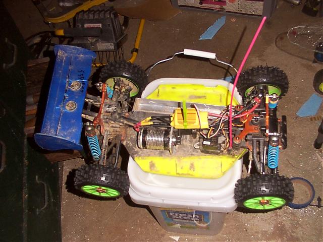

I did very slow rpm checks unloaded to make sure it even ran but thats all.
The motor spooled up and ran very smoothly during my QC tests. if it can run on a junk 40$ 100 amp esc it can run on anything. let me know how you like it when you get that 8ght rollin'
below are pics of my buggy powered by the same motor only in a 4 turn delta. its 4 teeth above stock and does 40ish on 3s 4300. 6 cells tore up too much grass and cought my esc on fire

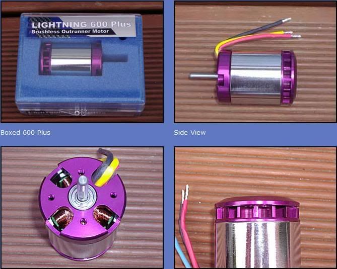

I am also looking into the Century Swift 600+ 1100kv motor for the 8ight. Here are a few pics...
RIP- Tammy (9/14/08)
  (#53)
brushlessboy16
brushlessboy16's Avatar
07.14.2008, 05:50 PM
gonna need to gear that thing to the moon and back to get decent speed
  (#54)
Takedown
WARNING: May become violent.
Takedown's Avatar
Posts: 2,426
Location: Wisconsin
07.14.2008, 05:53 PM
Getting it rewound to 1600kv delta 4 wind.
