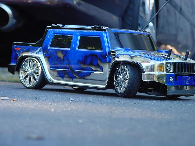

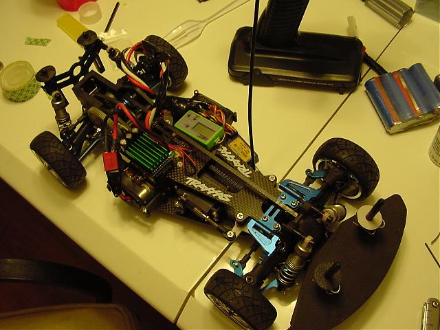

My 4-tec has a mm 7700, aluminum and graphite upgrades, light kit and custom widend stance. This is it for show. Its setup different for race.

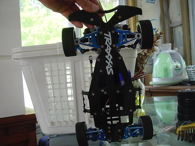

got any underbody pix?

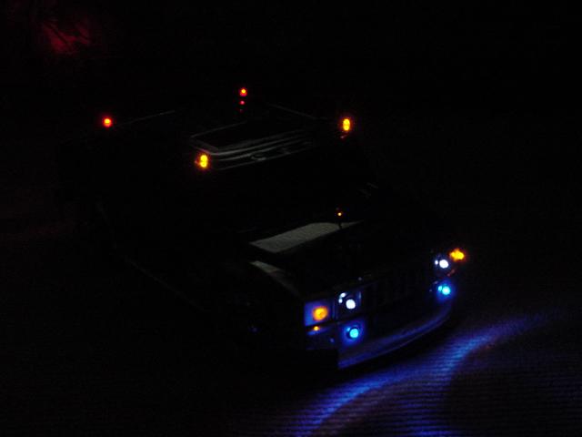

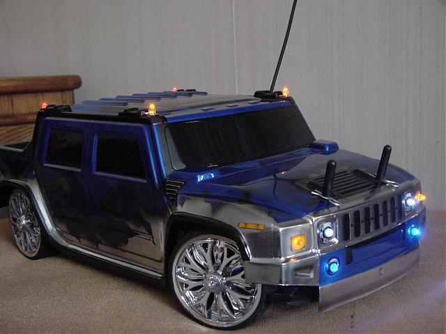

Thankyou! this thing is crazy quick to and handles extreamly well.

Looks great. From the outside, with the body on, it looks totally blinged out.
