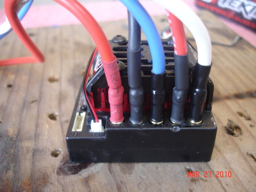

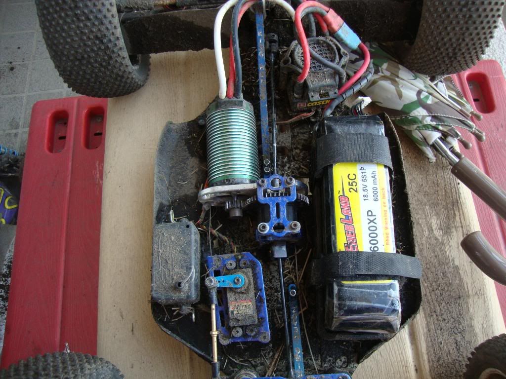

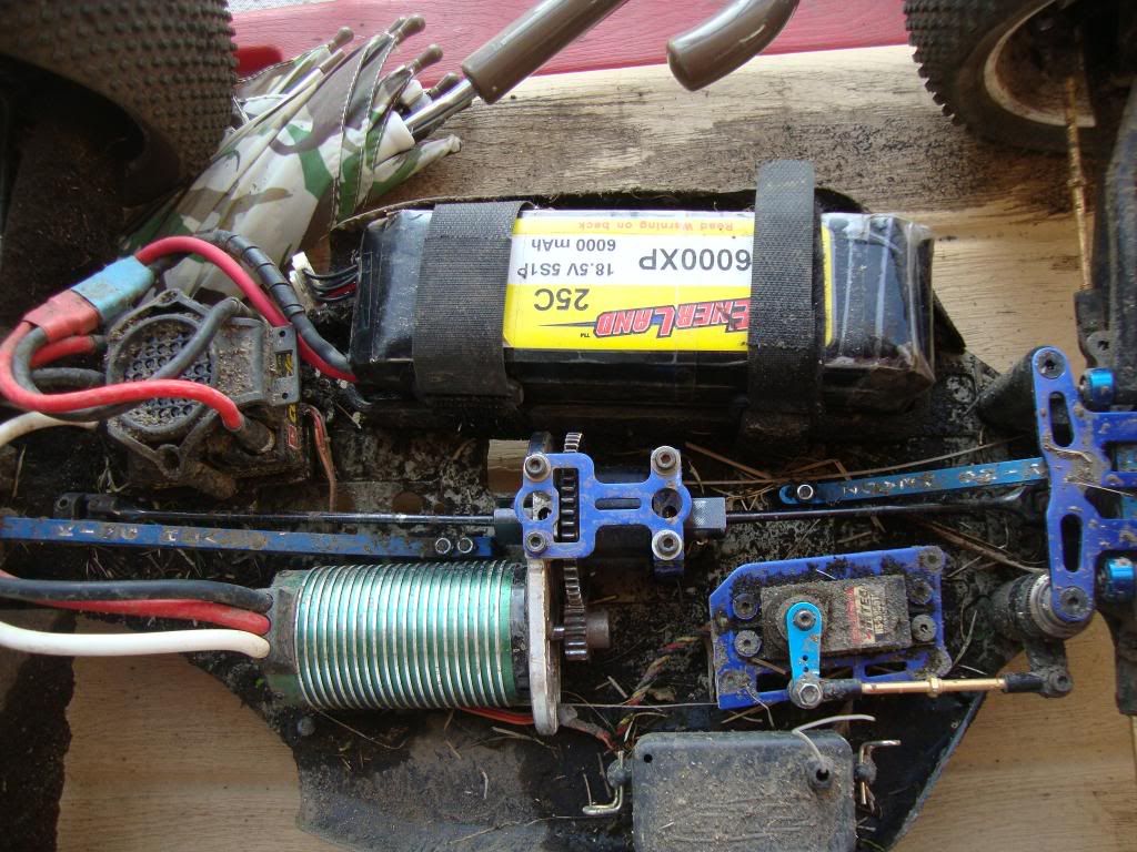

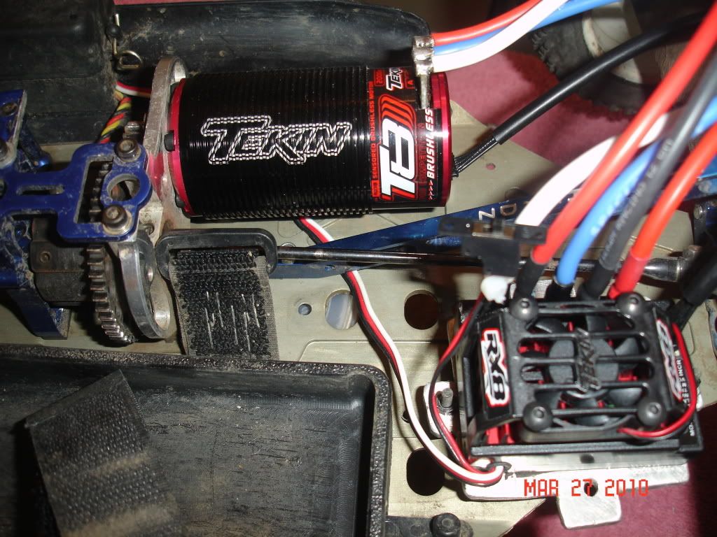

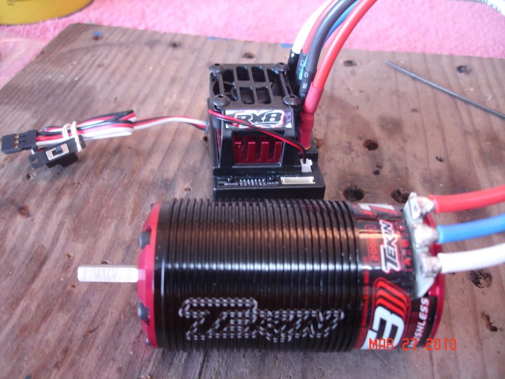

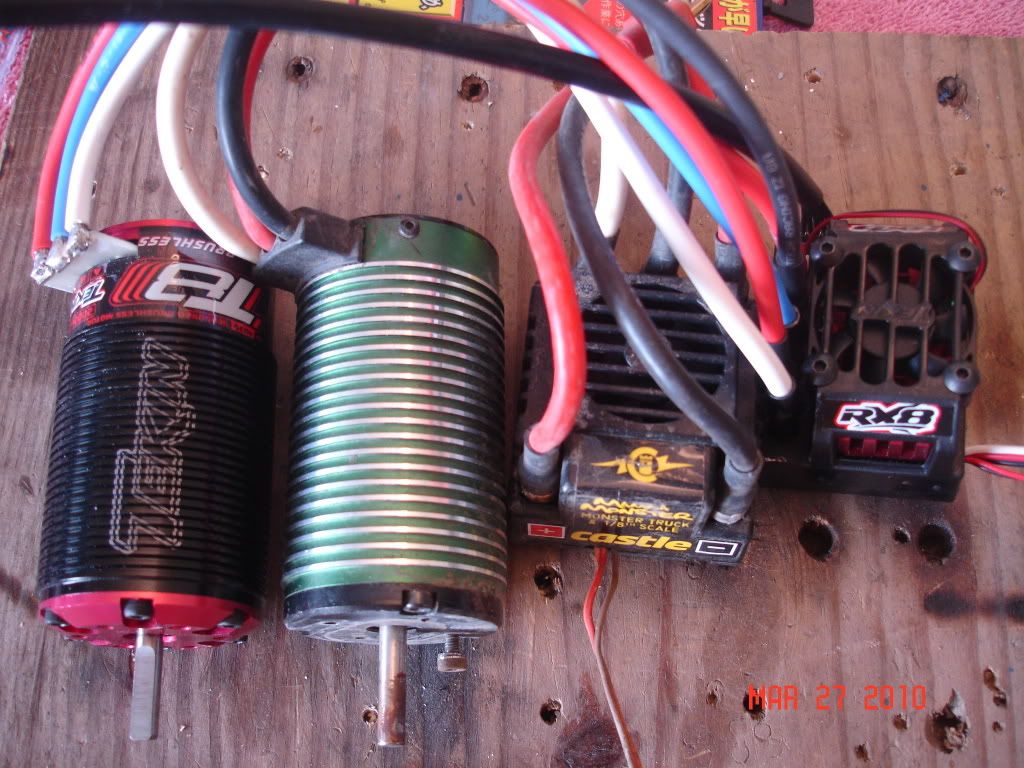

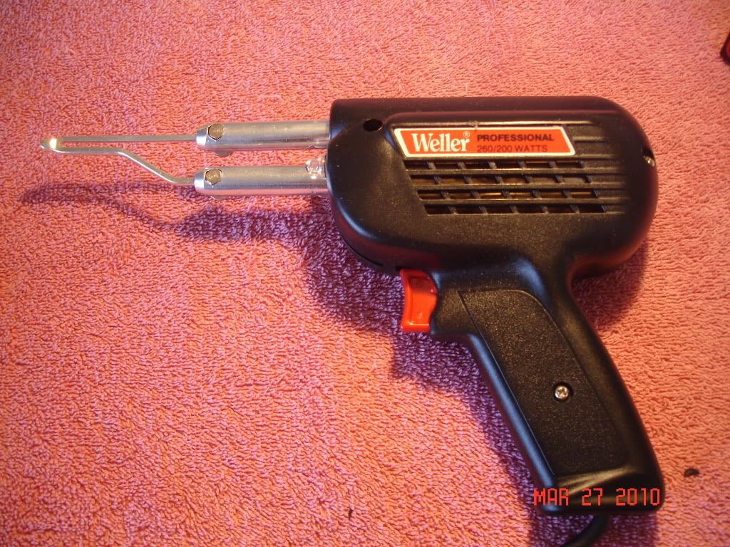

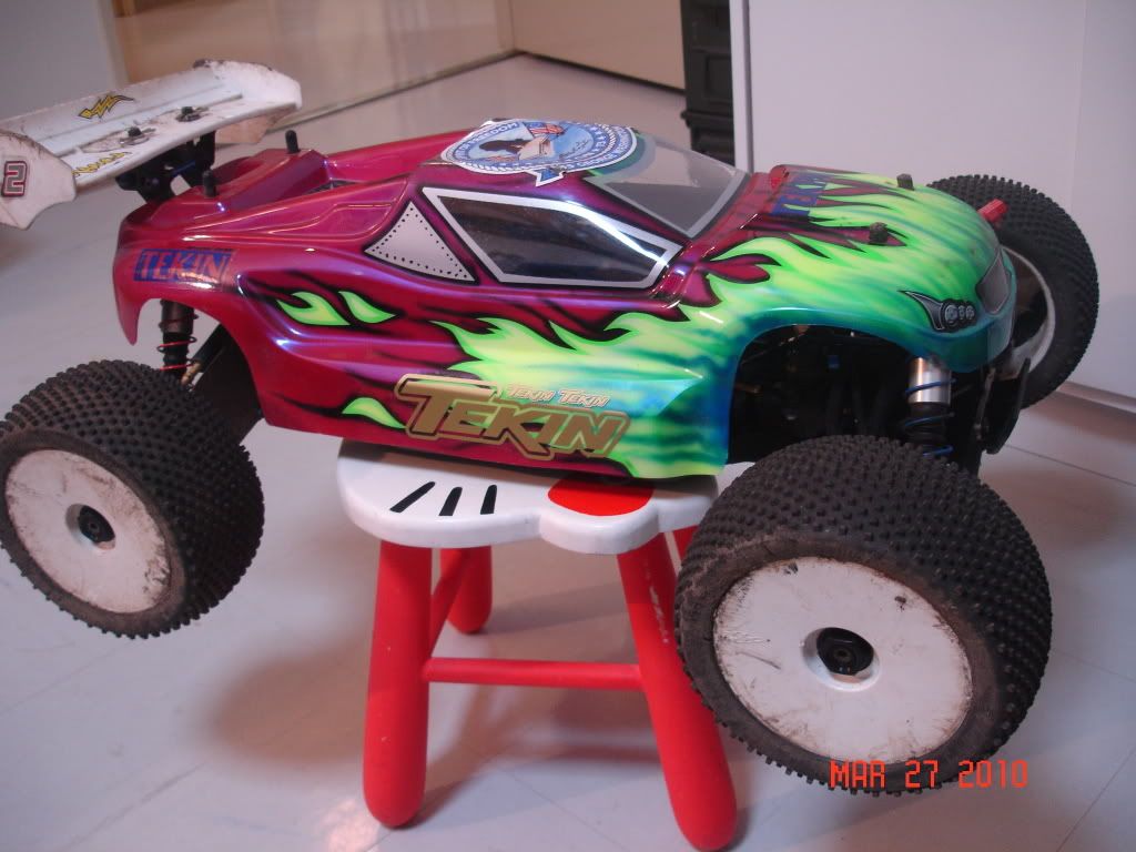

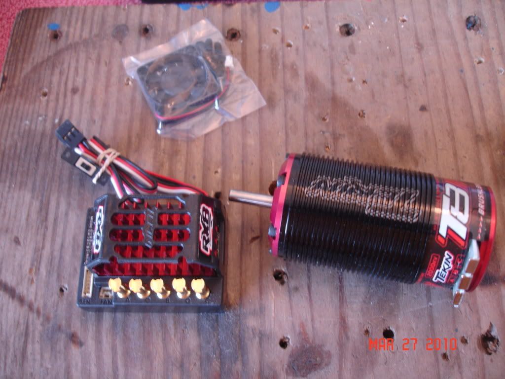

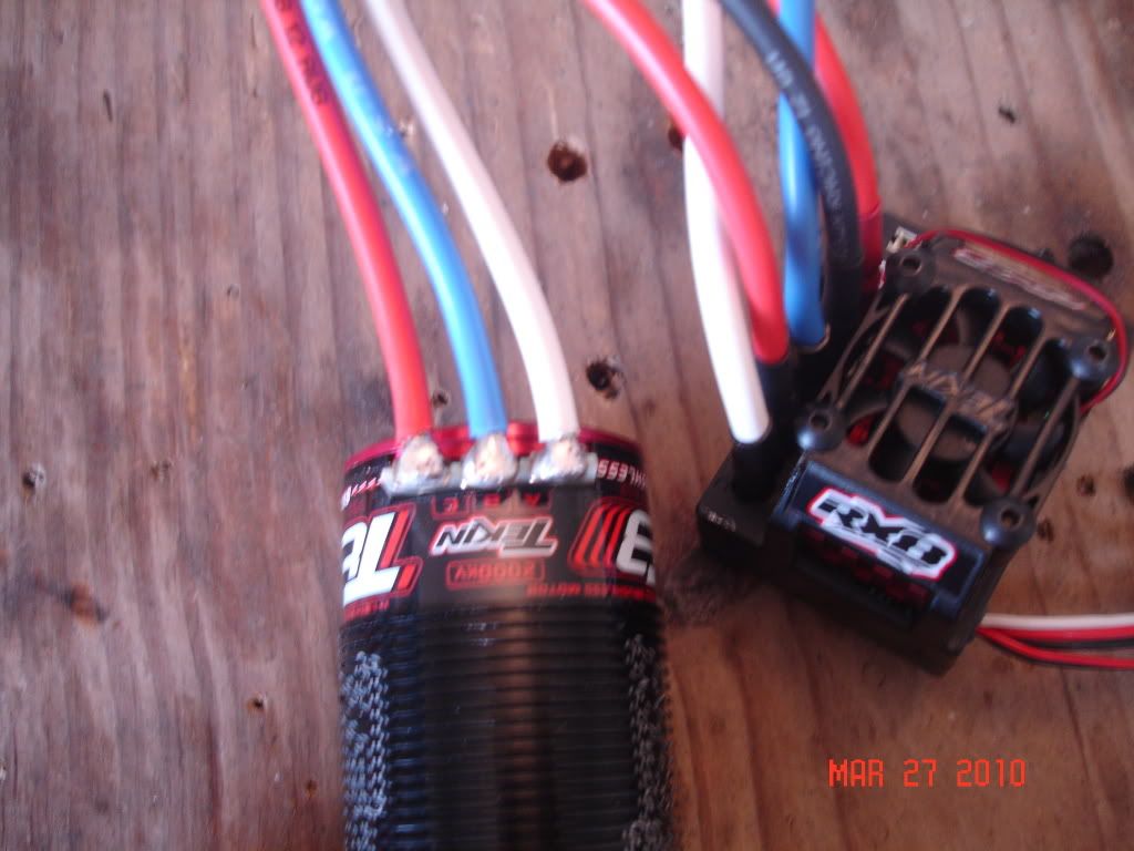

03.28.2010, 07:15 AM

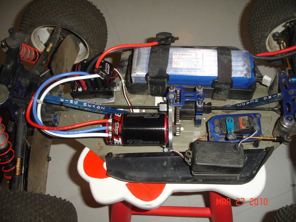

Well, I finally was able to solder and install the Tekin truggy combo into my ST RR. I ran it for a about 15 minutes today (just straight passes on asphalt) and I was surprised at the smoothness of it. It seems to be more powerful compared to the Castle/MMM combo because I was able to ride wheelies on the the truggy when normally it would not do it with the Castle combo. I will be changing the center diff oil to about 10-15K later to prevent wheelies. The Tekin motor is 2000Kv (equivalent to Neu 1515 2D).
Here are some pictures of the install.
My new Weller soldering gun:
Tekin RX8 and T8 2000Kv motor:
Soldered the wires. Tekin does not supply battery wires.
Side by side against Castle's combo:
Installed on the truggy:
Nice stickers:

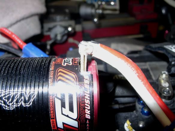

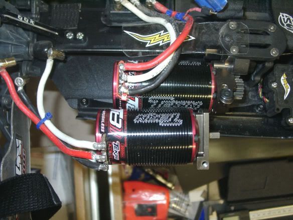

[QUOTE=George16;357657]Well, I finally was able to solder and install the Tekin truggy combo into my ST RR. I ran it for a about 15 minutes today (just straight passes on asphalt) and I was surprised at the smoothness of it. It seems to be more powerful compared to the Castle/MMM combo because I was able to ride wheelies on the the truggy when normally it would not do it with the Castle combo. I will be changing the center diff oil to about 10-15K later to prevent wheelies. The Tekin motor is 2000Kv (equivalent to Neu 1515 2D).
George very nice truggy. One thing I wanted to mention, I am also using a Tekin motor and if you have the motor wires soldered on out towards the back like you do the mass/momentum of the wire can pull the motor solder tabs away from the circuit board. I have rerouted my wires so they are mounted out towards the front of the motor and I have had no issues with the motor solder tabs.
Wire pulling the tabs away from the circuit board
Rerouted wiring over the motor vs out towards the rear.
Losi 2.0 8ight-E / Losi 2.0 8ight-E/T / jammin SCTRC10 / Slash 4x4 PE

I see what you mean. Thanks for the tip. I'll be rerouting them tonight.

Hey Lito, I got a similar weller soldering irons but my tips don't last. Is there a special way to clean the tips or maybe don't clean the tip like a normal soldering iron? Mine always seem to get a hole on the end of the soldering tip if that makes any sense.

I can't say for sure if this gun's tip will last long or not. On my 80W Weller iron, I tin the tip and remove the excess solder by using a wire brush. I brush it lightly prior to putting it away and so far, the tip is still intact.

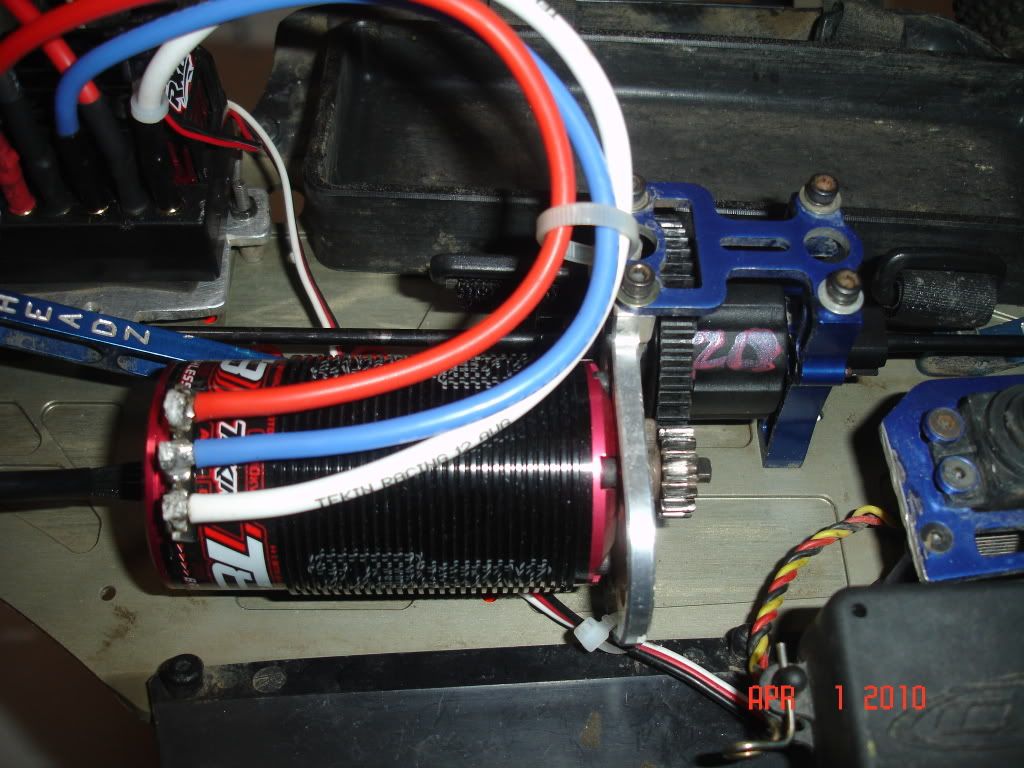

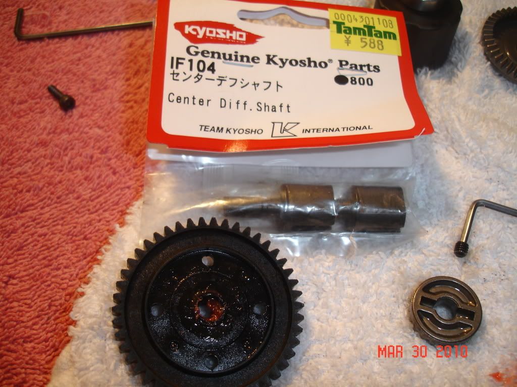

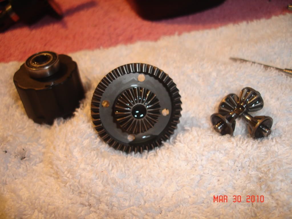

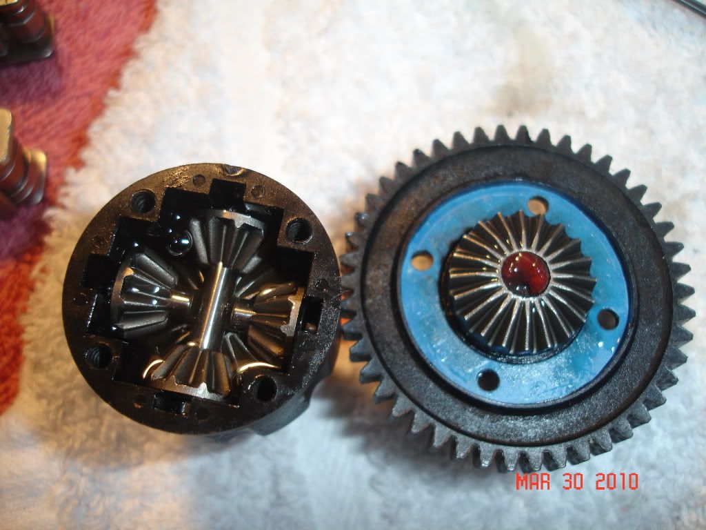

I removed the hardened gears from the Hot Bodies center diff and installed them into the Kyosho cup. I also went with 20K center diff oil but it will still wheelie on demand. I can flip my truggy if I want to. I'm also running a plastic 46T kyosho spur now with a 15T pinion.
I also flipped around the motor wires.
Pictures:
