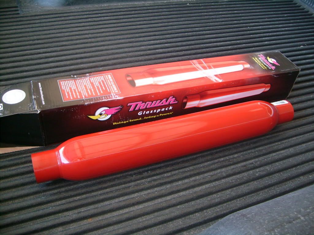

And a picture of the glasspack itself..

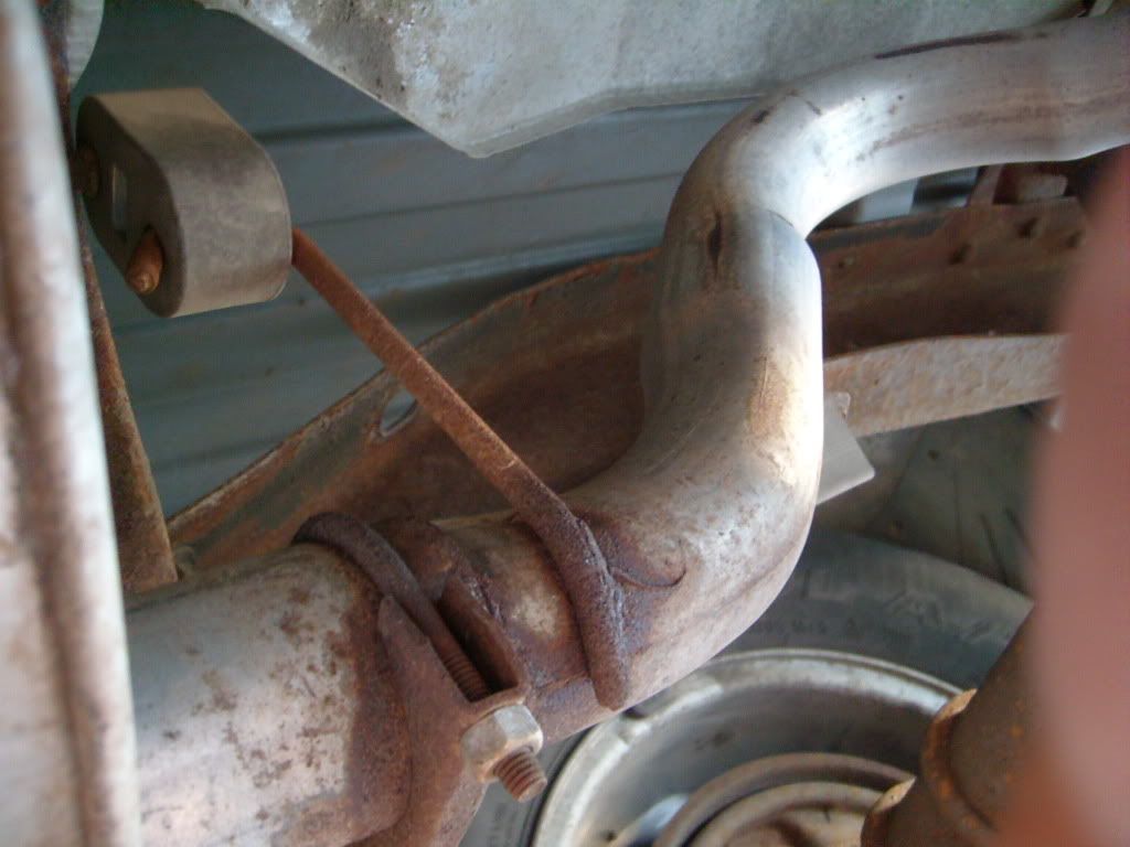

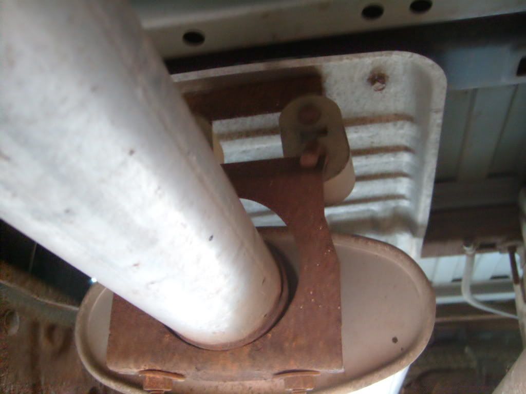

a couple clamps should be $5-10. you don't need heavy duty or anything. judging by the pics, it appears the front of the muffler is welded, and that is just a hanger. The rear that attaches to the tailpipe is most certainly a clamp. Get 'er dun
edit: the front is just clamped to the hanger (duh) should be easy

Yep, it basically pinches one pipe tightly over another.

u also need to know if the 2.5 is the inner diameter of the pipe or the outer diameter. if they are the same u can just connect them with band clamps but if the pipe on ur truck will fit over the glass pack that is the way to go and u can get a better fit less likely to leak, also if the old muffler is off set u will have problems with the fit. before u go cutting up ur old stuff besure u have a strait shot between the pipes after u cut the muffler out.

The glasspack fits over the existing pipe. I want to get it installed this weekend if I have time. The part I am nervous about is cutting the existing pipe and hanging the front of the glasspack....

once you get the clamps off, in thoery, it should pull apart with no cutting required. Of course, they may be rusted together, that's where the BFH comes in. Soak the joints and clamp nuts with penetrating oil about 15 min. before you start, it may make things easier. It looks to me like you could bend/push/pull/whack the front mount to work with the glass pack, and the rear mount is attached to the tailpipe, not the muffler, so your rear is set.
