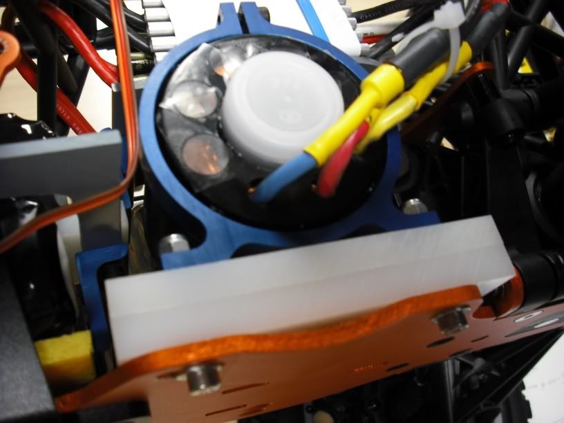

I am guessing he is refering to the OSE mounts I linked to. I was going to use them as a rear support, and bolt the front of the motor on as is usually done. I do not plan to make much adjustment, as my pinion choice (and power delivery) is limited.

Anyways, I only have to buy about 250 bucks worth of stuff to convert the baja, and I was mocking up the motors earlier and it looks like I will have plenty of room for them and the escs in the gas engine location. Plus the lipos will fit where the tank sits. I can even keep the stock radio tray. I may have to move the brake servo, not sure if the linkage will clear the top motor.
I also plan to run front brakes, so I may need a pair of servos, but the m11 can handle that. the 4th channel is a slave to the throttle channel, so I can even bias the brakes thru the radio.

So I pulled the engine and tank, and started eyeballing the leftover space. The motors look quite easy to mount, and I think I have figured out a center brace that will support the rear chassis. Worst part will be trying to get everything lined up correctly. I need to order the pinions and go from there, then I will be able to see if my motor mount ideas will work. So this project may take a while...
