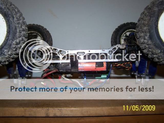

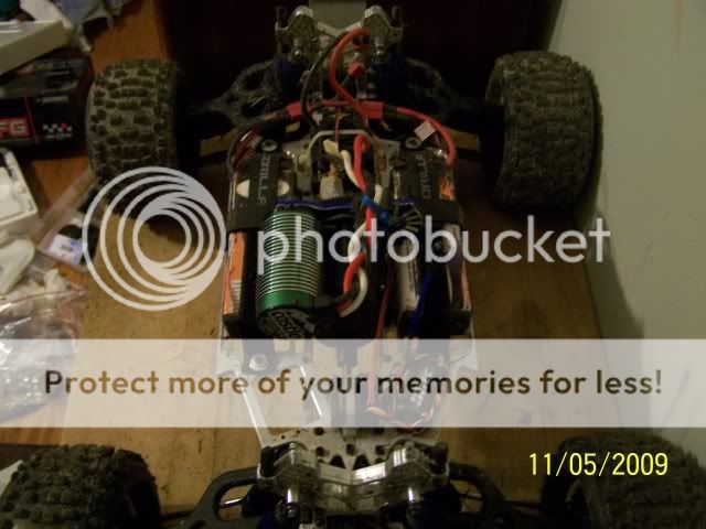

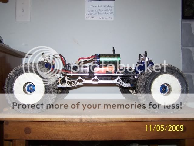

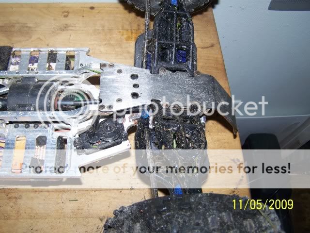

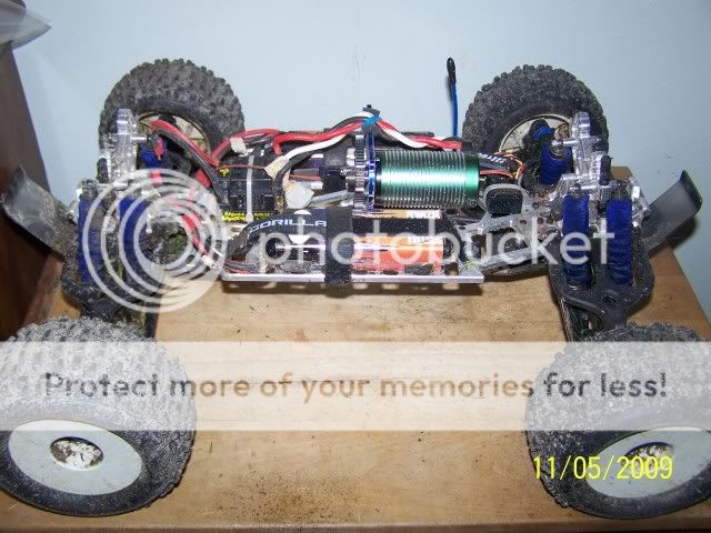

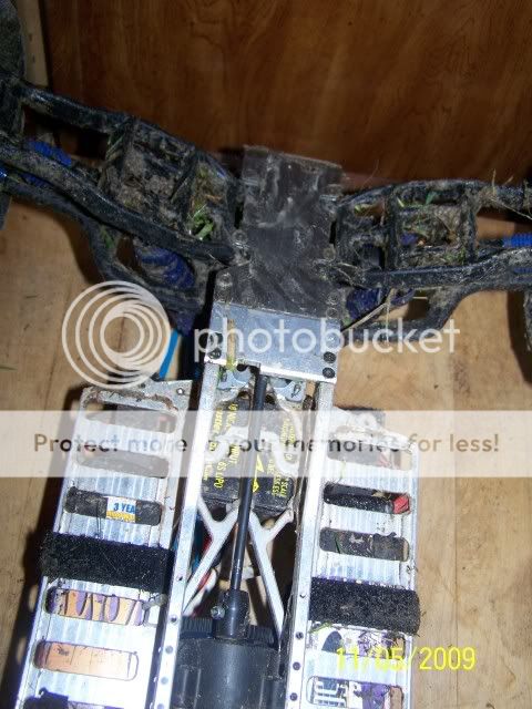

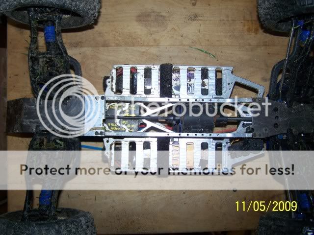

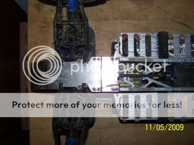

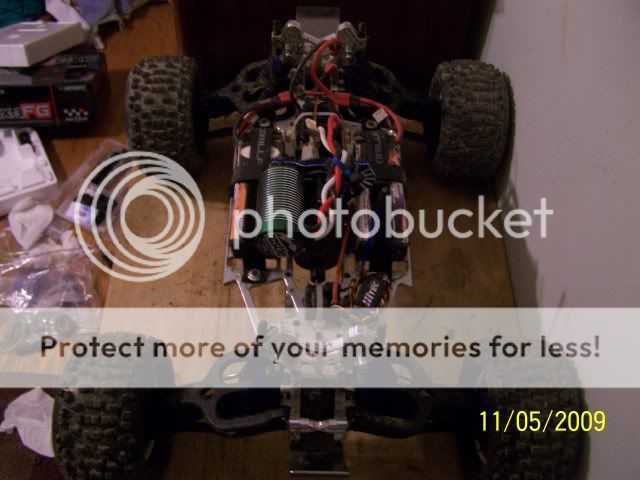

The beast is done... Not really... at all, in fact I've still got stuff in trucks on their way to me lol, but at this point I'm happy with it finally.
Photos were taken a short while ago after a mild night run. It is a pleasure to drive espcially with the recent upgrades: Airtronics MX-3FG FFHS-2 2.4Ghz, 2x Ext wheelbase, and with the RPM True Track I know I can now take a poor landing. Oh and the mod I had to do with the UE dogbone has held up fine so far. It hasn't been above 80*F or rattled out.

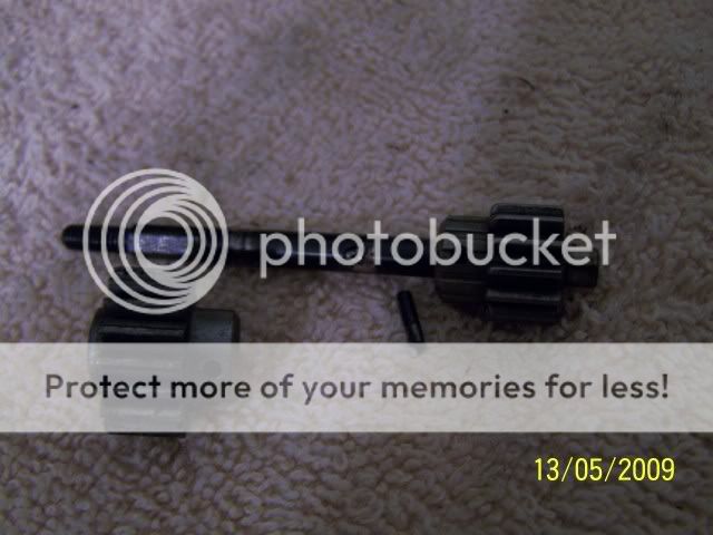

Bottom line> What should I do? Short of just wait on Mike to ship some Maxx CD and motor mounts...

Hmmm, I had this problem a couple moths ago... I made a real back yard temporary fix by bending (then bend allows for a tight fit) and cutting a old allen key then tapping it into place...
It's been holding up with no worries since then.

I used a drill bit shank, that is m2 steel and quite a bit stronger than the stock roll pin. Just find a bit that will be a press fit, cut it a bit longer than needed and press it in with a bench vise. You can grind on end to a cone shape (semi point) to get it to line up easier.

I'm using a G-Maxx tranny, but I did the same thing as Lincpimp. I broke the original with the stock Titans and used a bent allen key and a bench vice. After the G-maxx tranny, I used a drill bit blank.
Mcmaster has them for cheap, or your local hardware store should have some.
Make sure that when you "press" it in with the bench vice, that the ends are nice and "mushroomed" so it doesn't come out again. It will tear the plastic case, and just make a mess in aluminum.

I had the stock pin sheer into 3 pieces and get mushed into the output gear- not a pretty sight. I used a short piece of allen key too but JBWelded it in place- no problems since. As for what to do with an open tranny (sure theres a good joke in there somewhere), I suggest simply bolting the 2nd gear out put gear (smaller one closest the motor mount side of the tranny) to the dog carrier- basically a cheaper version of buying the gmaxx single speed conversion kit, but has the same effect of locking it into second permanently.

Zack the G-Maxx single speed tranny rocks! In fact believe it or not I still have the roll pin!! Not broken yet. I responded in that other forum...drill bit or allen wrench and you'll be fine.

Thanx guys! That has been takin care of due to the great, quick advice!

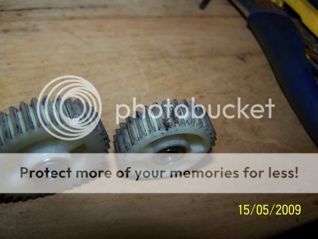

Then I found this:
I don't know if you can tell from the picture but it's a pin shaped slot in the gear. When the pin pulled halfway out and broke of it got in the mesh. Maybe still usable? It doesn't really matter if it is still usable or not, it was only $2.75 so I bought one...
More parts are one the way! Addicted? ...Nooo... lol Maybe but I just really set out to have a practical beater with super rare apperences at the track.
This MMM combo really makes life miserable for stock Traxxas parts. LOL Only about 30% of the steering componants are stock and most of the tranny. That is all that is left! ... And they are on the way out.
