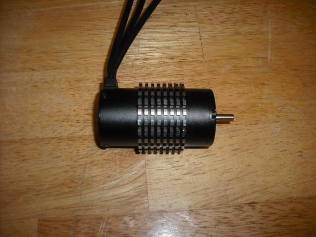

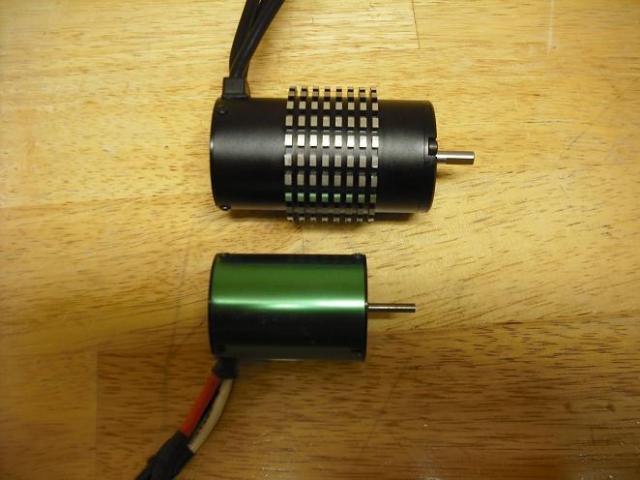

The heart of the Beast!!!
Big House
Big House's Avatar
Posts: 372
The heart of the Beast!!! - 08.07.2009, 10:51 PM
Here is the heart of the beast. And looks how it compares to the regular Mamba motor.

08.07.2009, 11:03 PM
FYI You might need to grind some fins off...
Big House
Big House's Avatar
Posts: 372
08.07.2009, 11:08 PM
Why is that? I think that might give me the horizontal support i was concerned about.
08.07.2009, 11:13 PM
you generally want to allow it to flex - Otherwise chassis flex actually bends motor mount which will screw up your mesh...
Big House
Big House's Avatar
Posts: 372
08.07.2009, 11:28 PM
The 4.4mm CF top support plates and 4.4mm CF chassis...Flex will not be an issue... that is why I want the motor locked in as solid as possible.
