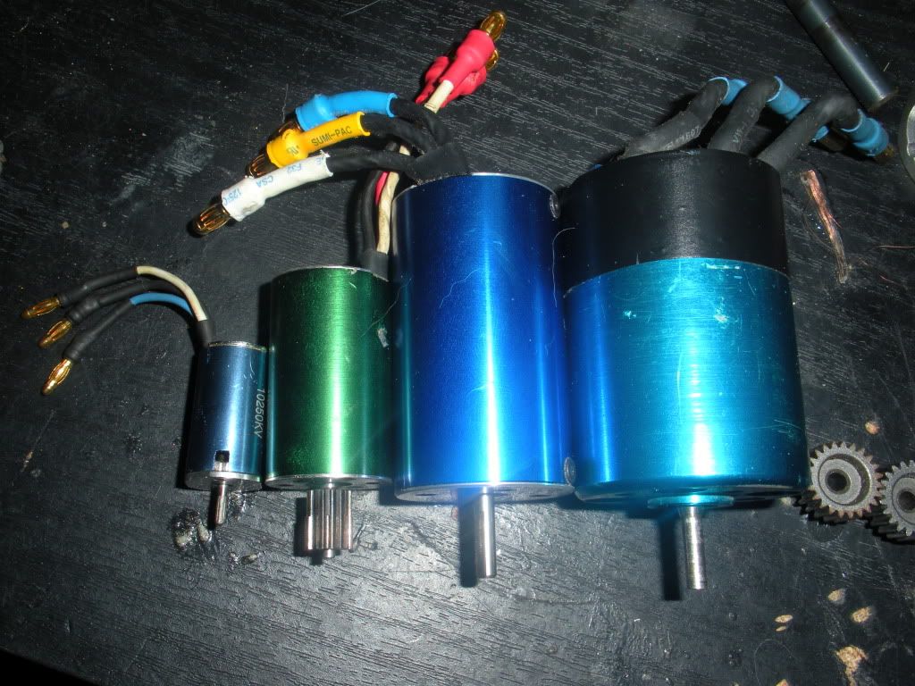

Wait so the mini e-revo uses a 36mm motor!? My god I might have to get one now.... Run a 4s 2200 mah system with a Medusa and mamba max. Hell Yeah.
Has anyone tried fitting a 2200 cell in there yet?
No, I found it's a 380 motor so a 28mm medusa would have to do.
Yes it uses a 380 size motor wich is a medusa 28mm series, But in those pics you can see that a Medusa 36-50-???? can fit with some very little modding, Just dremel a bit off the rear shock holder and it will fit, This is what i plan to do when my VXL system dies, This thing is stupid on the 3s 380 I can't imagine 4s 540 can.... I can fit my zippy 3s 1600mah packs in there, There a tight squeeze bit they fit....

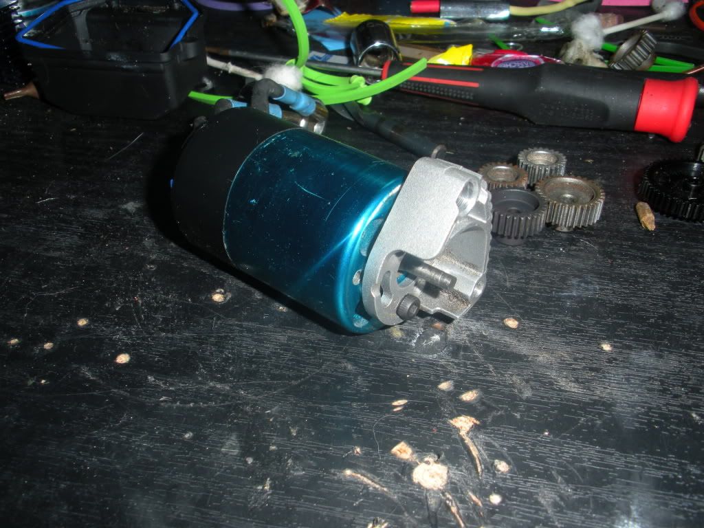

I just spent the better part of last night cramming a Neu 1112 into my 1/16 E-Revo. I haven't even ran the truck.
I'll be using a Mamba Max ESC in it and will be switching between 2S2P and 4S1P (I bought 2S 2200mah Zipp packs). I'll also be running a Castle BEC. Seems like overkill in a small truck but I guess this is what it takes to have a (extremely overly-) powerful setup that will run ice cool no matter what I throw at it.
I had to dremel the rear shock Tower and cut the shaft down on the motor (the Neu shaft was a solid 1/8" too long). I also ground a flat spot.
This weekend I hope to fab up the ESC mount (I'm going to make a mount out of aluminum that slides into the stock ESC mount tabs so I can slide my ESC out just like stock).
