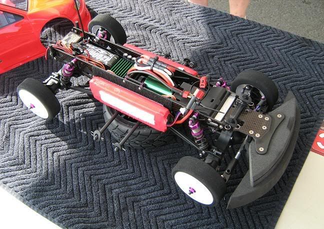

What I meant to say I was thinking making a front bumper kinda like a combo bumper splitter shaped like a wing to help direct airflow up and over and around the outside of the tires. Kinda like this but shaped better.
Hard to believe this is the record holder. but it is 72.9 mph talk about Isnt that a 10th scale esc and motor? but it is from 2007.

Funny that the record holder is ineligible under current rules, but good for the sport that the rules are now there.

Why wouldnt he be legal harold ? I dont really see anything wrong with it. Swiss cheese ain't going to cut it harold LOL. I dont mind anybodies ideas, my brain is tacked out trying to figure out what I need to get and what to do next. I have had the flue all this week so I started working on the truck again today. I am going to do some testing with out a wing but I might need the verticle uprights for high speed stability. OverrevO said the modified wing actually helps stabilize the car at speed. So I am sure it would help.

his wheels were inside the body IIRC and I thought they made some rules about tire size that would make it ineligible. You're making me question myself now, I'm going to have to re-read the rules!
edit: re read the rules and I'm confused. I thought there was a specific monster truck class with MT rules. I thought I also read about a seperate speed challenge elsewhere. I think I'm getting the two confused. My bad!

You know what the wheels do need to be outside the body but I never did see a pic of that truck with a body on so I dont know. They use to have a separate MT class now its just an open wheel class. Not really fair because I will be competing against buggies and any open wheels car.

He was discredited later for running foams and essentially a touring car body. The next guy behind him was a 3906 emaxx that went 70.1mph. He was on this board for a while. Twin 6XL's I believe on 5S. His name is JohnnyMax
