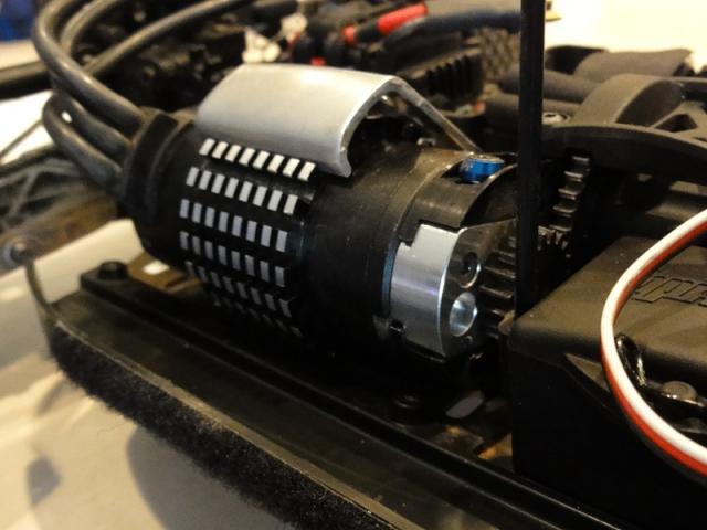

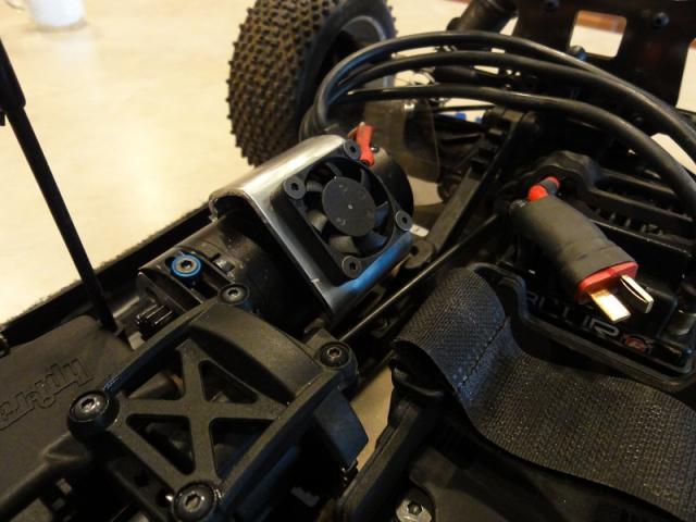

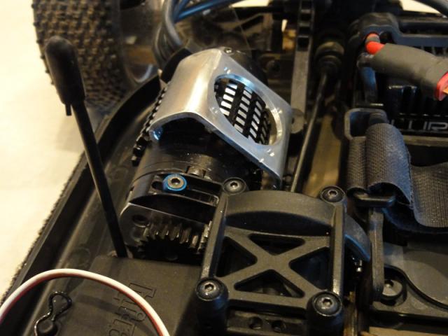

Just thought I'd share what I came up with for fan mount for my Flux motor.
It is made so that it is keyed and fits tightly between the heat sinks on the motor. I have to lightly tap it (slide from the front) with a hammer to get into place.
Test ran it at a race last night, and it didn't move at all. Very happy with how it turned out. Motor temps were great too. I made some other changes that helped with motor temps, but I know the fan is helping too.

Thanks Patrick. Posted just incase someone was struggling like I was with how to mount a fan on this motor. Not sure there is a market for them, but feel free to use the idea if you want to make a fan mount for the Flux motor.
