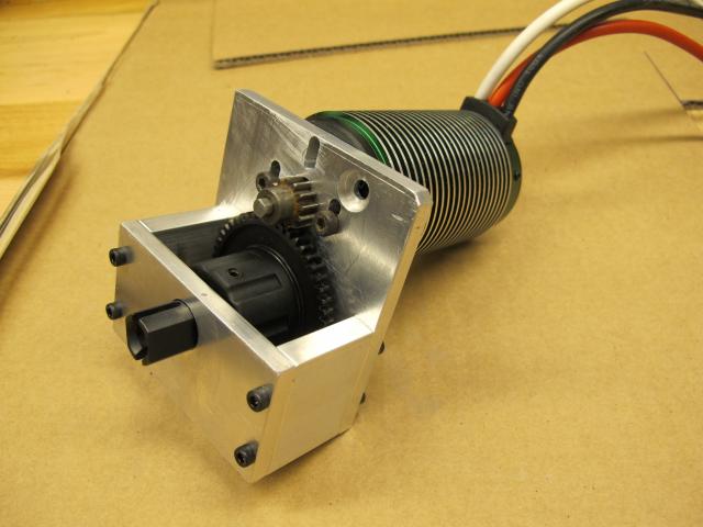

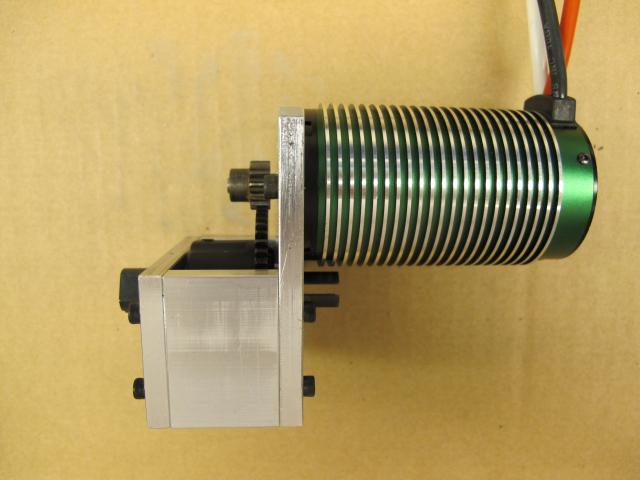

CD & motor mount done. Nothing Fancy. Should be able to accept down to 10T pinions - might need to file down 3 of the ribs on the engine for that. Engine plate is 6mm. hope it will hold the 1717 alright... time will tell ;)
The circular hole in the motor plate is proff that we consider the environment and recycle as best we can :)

  (#50)
Jahay
Posts: 1,007
Join Date: Apr 2010
03.29.2011, 07:17 AM
Nice work on the mount!!! Clean job!!!

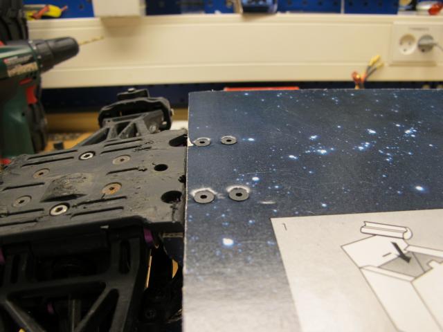

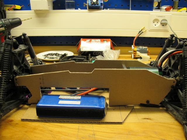

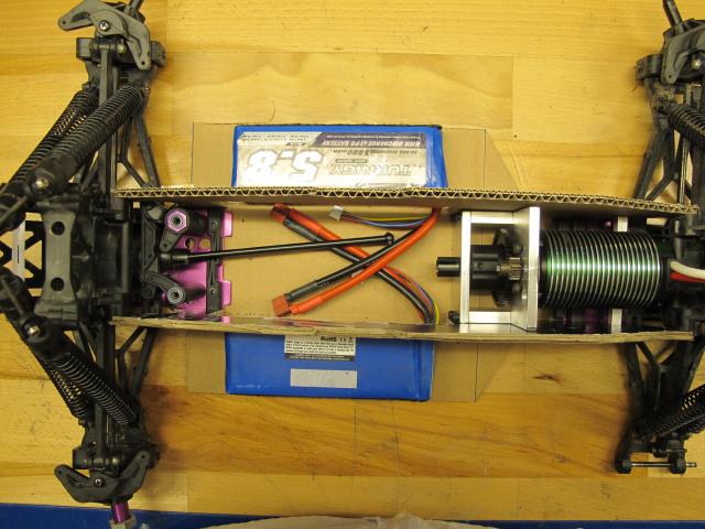

More or less ending up in a G-Maxx layout I think... Question is if I should keep the cut out and try to get the bats as close to the dogbone as possible or simply use the TVPs as sidewall in the battery "tray". Having the bats outside would leave plenty of room for the wires ;)
Cut out placement:
Bats outside TVPs:
Pretty low CoG:
Skidplate mounting to the front bulkhead. Using the 4 existing screws in that area. Just swapping them to slightly longer counter sunk screws. the rear will bolt with 4 screws into the CD mount (CD mount will bolt into TVPs with 8 screws)
Expecting to use 3mm alu for the skidplate and trim TVPs/skid as best I can to loose weight at a later time.

  (#52)
Nixpus
Posts: 138
Join Date: May 2009
Location: Denmark
03.29.2011, 07:45 AM
Brian G's speed calc gives me theese figures when I run 40 series mashers (6.6 inches) and add 0.25 of ballooning. They are belted... hope it will last ;)
Anyway, the speeds come out like this:
10T 44.22 mph
11T 48.64 mph
12T 53.06 mph
13T 57.48 mph
14T 61.90 mph
No clue on wear... but I my 13T pinion didn't wear too bad last season (Robinson racing). Have 9-10-11T Novak pinion in the mail :)
  (#53)
Jahay
Posts: 1,007
Join Date: Apr 2010
03.29.2011, 08:02 AM
hmmm i would look to gear 12t or so....according to those numbers...
Doubt you should have any probs with heat issues running such a bit motor and 6s.
I would personally like to have the batteries half inside the chassis... But it could make strapping them in a little awkward?
  (#54)
Bmr4life
Posts: 453
Join Date: Mar 2006
03.29.2011, 08:17 AM
That mount is great. I'll definitely be copying that for my Savage. I want to try using 3/8 lexan though since I have a lot of it laying around.
  (#55)
Nixpus
Posts: 138
Join Date: May 2009
Location: Denmark
03.29.2011, 08:51 AM
Looking forward to a lexan version Brm4life :)
Jahay, your right. Moving the bats too far out on the sides will mess up more than it will fix... I was hell bend on having the wires inside the TVPs but in reality it doesn't matter. Will flip the batteries 180° and push them as close to the center as possible. Strapping will be solved... somehow... ;)

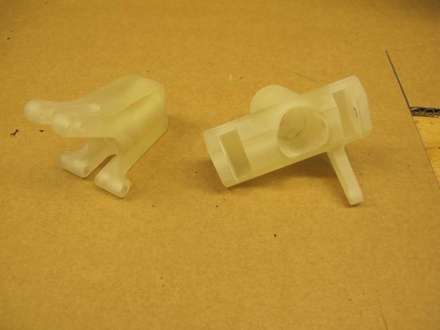

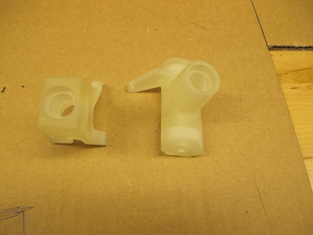

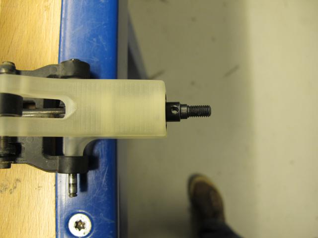

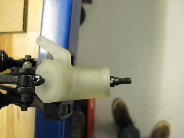

Look what the new 3D printer coughed up with :)
Its nothing short of amazing that you can do prototyping this way!

  (#57)
thzero
Posts: 800
Join Date: Oct 2009
03.30.2011, 10:57 AM
nice!

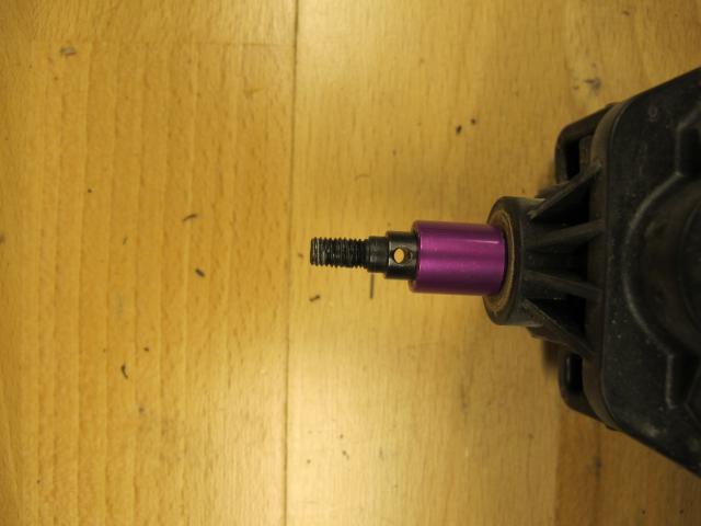

I like the extended parts, help distribute the load on the XL axle. However there is still a problem with the XL (and X) axle with the pin being so close to the threads; with the bigger wheels I snapped a bunch of XL axles at where the threads meet the rest of the axle. If you are making parts, I'd really look to replacing the XL axle with a truggy style axle; or at very least look to putting another hole in the axle further up the axle and using a truggy hex adapter or truggy axle extender, sorta like what I did with the XL axles to mount the Baja 5B 24mm hex hubs.

  (#58)
Nixpus

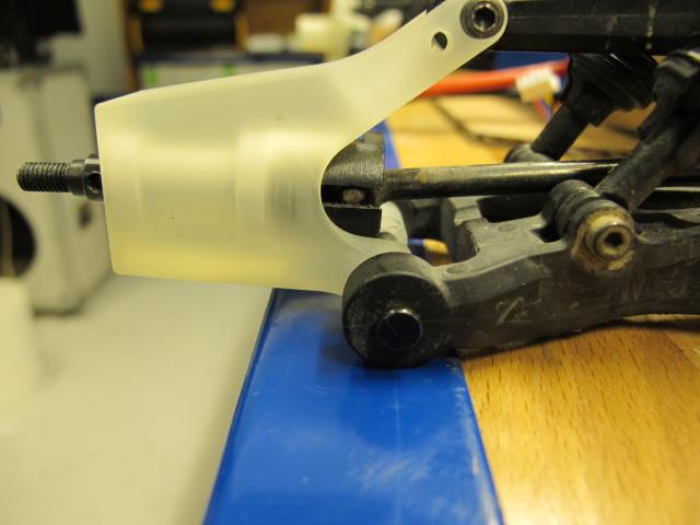

03.30.2011, 11:00 AM
Seems like we need to push the rear bearing a bit back - 1mm should do.
Might have to push the whole front a bit. That dogbone has a fair bit of play!
In the front we need to adjust the opposite way... fun :)
We also need to shave off a good bit of material... because as it is we have 2° steering throw in both directions... we need as much as the standard setup and then some!
This is where the pin hole should be positioned.

  (#59)
thzero
Posts: 800
Join Date: Oct 2009
03.30.2011, 11:07 AM
Something like the hex for the RC8T (http://www3.towerhobbies.com/cgi-bin...?&I=LXVKH7&P=Z) is what I was thinking of. If I could find someone that could drill a pin hole (perpendicular to the existing one) so that the end of the RC8T hex nut is within .5mm of the bearing, I would be happy.
  (#60)
Jahay
Posts: 1,007
Join Date: Apr 2010
03.30.2011, 11:08 AM
that is so impressive! Im loving these 3d printers!!!
How long and how much is it to print a single hub like that? Also how fragile are those 3d prints???
To get rid of the xl axle, why not make use of the savage 5t truggy style axle. And build this hub to that specification so the pin is in the perfect place?
