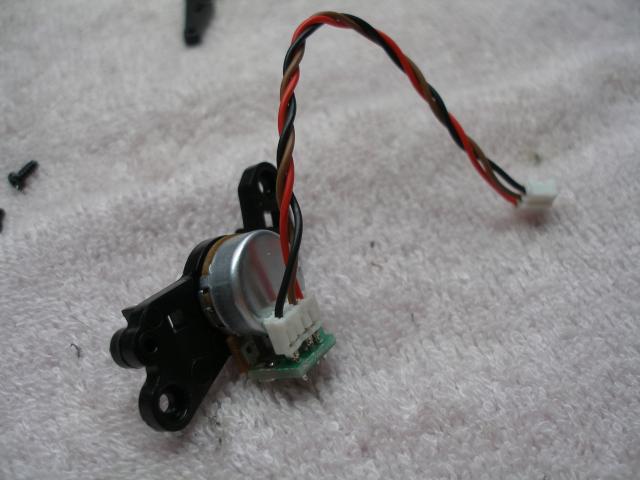

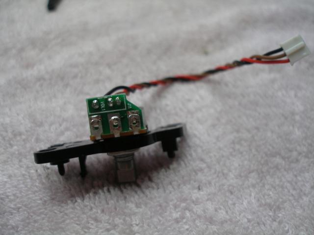

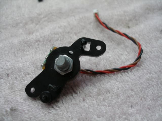

I purchased this same radio a couple months ago and have hit and miss luck with it at best. This thread has inspired me to trouble shoot and disassemble it.
The first few times I used it it worked flawlessly, slowly but surely It started acting up. I thought at first it was the ESC because the RC would cog and hardly move backwards. Then I tried reprograming the TX to the ESC and never could get the reverse function to work again regardless what I did. At best the reverse would work as described earlier as cogging and no power. A different radio and RX and everything worked perfect. I then tried the 6 different Flysky RX's I have and all did the same, then I tried multiple ESC's and the problem presists. I firmly believe it's the Forward and Reverse switch on the TX. I've removed it and sent a email to Flysky asking if this part can be purchased seperately. I would like to test this at home but have no idea how. Can this switch be found at the local RadioShack ?

Bondo, I would put a soldering iron on all the connectors, just to eliminate cold solder joints. Then you can open up your "switch" aka potentiometer and clean it out. I use to spray just plain wd40 in those things for lubrication and cleaning.

OK, After hitting all connections with solder iron and wd40 the switch it's still the same
Reverse has no power at all and stutters, again this happens with all 6 Flysky Receivers regardless what ESC is being used.
Was worth a shot, thanks anyway Snell

use an ohm meter to see what rating the potentiometer has, or to see if it is malfunctioning (resistance should gradually change as you rotate the dial).
  (#54)
03.23.2011, 04:33 PM
Like brainanator suggested, measure between one of the outer legs to the middle leg and see if the resistance changes smoothly as you rotate the pot. Might want to do the same except with the other outer leg and the middle leg (resistance will change opposite). Go slow when adjusting/measuring though because it may be difficult to see irregular changes on a meter. The pot could simply be "noisy", which may not be visible on a meter; this could cause havoc with the radio electronics too.
That pot looks like a fairly standard part. Even mounts using the shaft collar. Depending on the value, a replacement may be available at RadioShack. To get the value, simply measure the resistance across the two outer legs (the middle is the "wiper"). If RS does have the matching value, make sure it is "linear taper", not "audio taper" (the audio taper resistance changes exponentially to compensate how humans perceive sound). The power rating is irrelevant for what it is being used for as long as the replacement is close to the same size (no PCB mount pots ).
You might also want to see how much extra room (if any) is available around the pot once installed in the radio in case the replacement is physically larger.
Then, it's just a matter of swapping the pots. You could eliminate extra points of potential failure by cutting the connector off that pigtail in your pic and soldering the wires directly to the pot - just make sure you know which wire goes to which pot lead.
Honestly, how hard would it be for manufacturers to use a rotary encoder device instead of a pot? This unit is inexpensive, so I can understand using standard parts, but some of the radios we use are rather expensive and you'd think they would use something that would last a bit longer.
