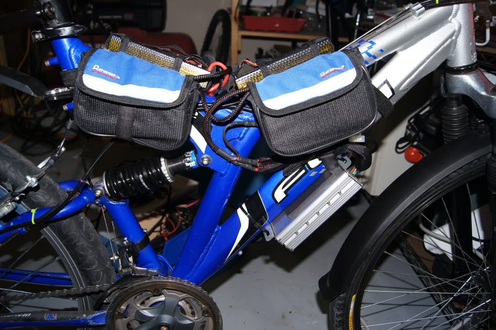

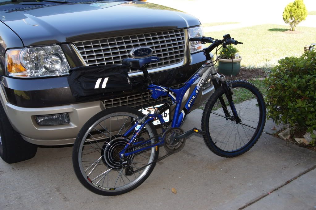

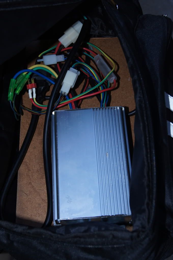

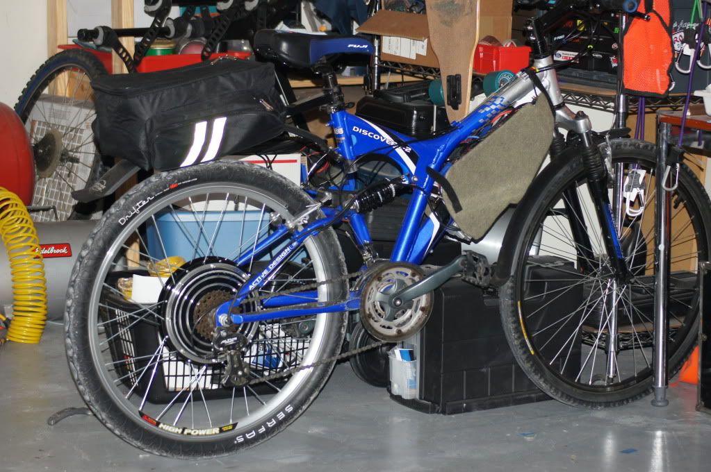

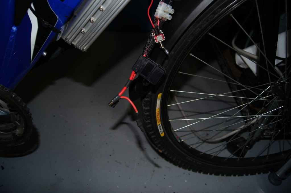

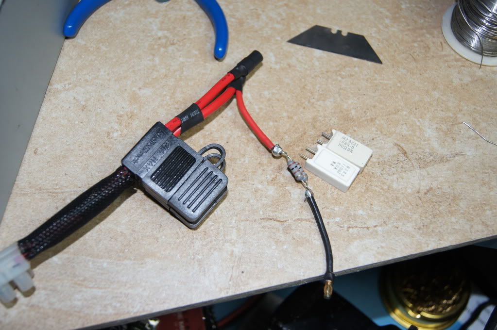

Added 30A fuses to both the positive and negative wire. Swapped out the deans for 5mm bullet connectors for the ease of using the precharge resistors. I use dual 1W 100Ohms resistors. Zero sparks now with 20S lipo. My setup doesn't look stealth anymore though. I had to choice as it was 95F today and there is no way the speed controller would keep it's head cool in the closed bag.

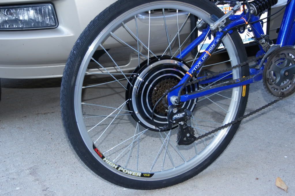

As of 12pm, I've reconfigured the bike to 18S. The hub was getting to 125F with the 20S and a few mph less isn't going to kill me.

Ok, so I averaged 38mph with the 22s. Motor hub was 99F, controller was less than that. I peaked at 49.48A, which calculates to over 4000W. I was pulling 20A continuous at max throttle and used 2629mah.

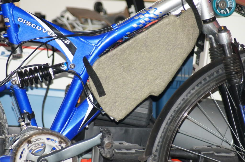

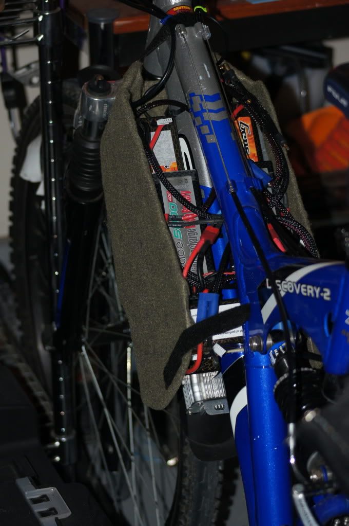

05.29.2011, 09:24 PM
Made a ghetto fiberglass tub and covered it with me favorite green/black fleece. Bike handles better now.
