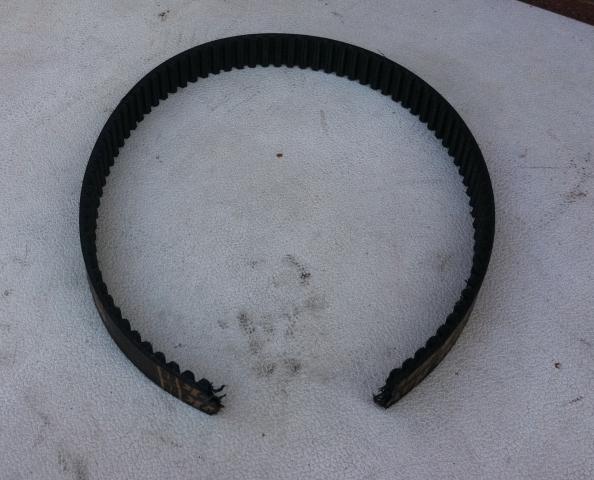

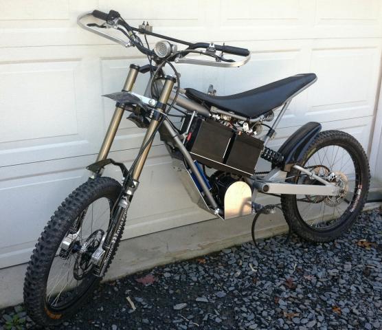

Got the modules installed last night and went for a night run! WOW what a difference the lipo conversion made. First ran at 66% current limit(200 amps) then in full power mode(300 amps at 74 volts in theory, though in unlimited mode it bursts higher amps). Full power mode is downright scary - I seriously am in need of a better throttle(only 90 degrees of twist makes for a twitchy ride) - I would like to get a 120 degree throttle to add some resolution for sure. The gearing tops it out at around 43mph and it gets there in a hurry! At 25, if you grab full throttle, it will throw you off the back unless you let up quickly - feels like a kx250 when it hits the powerband! I dialed in a progressive curve and went back to 80% current limit(240 amps) - theoretically limiting the power to around 20HP, which is plenty for a 150lb machine. I am totally psyched!
Oh...before i dialed back the power, i managed to rip the primary drive belt in two(hanging off the foot peg). I hope to get some body panels done this week to cover the batts/wiring a bit. Here is a picture:

the bike and the broken belt

Hey mike, nice bike. What is the range on the stock bike? What is the expected range on your battery conversion? I love that you used basically off the shelf batteries, makes fixing and replacing components easier. If i ever lose enough weight, i'd like to get a E-bike for commuting to work. I would look into this setup, as i know the guy doing it is one of the best in the area of engineering and ergonomic and wouldn't sell anything that either doesn't work , or he wouldn't use or ride himself.

Mike that looks AWSOME.

Those modules look awesome, very clean look. ''Looks factory'' like Chip Foose says. The whole bike is pretty darn sweet.
Now I'm having a hard time figuring this out. I presently run on 48V 34 amp SLAs. To get to close to the 48V mark with lipos, do I need to go with 12 or 13 cells? 3.7V nominal times 12 = 44.4V or 3.7V nominal times 13 = 48.1V. Which one is it? If 12 cells is the number I need it seems a lot easier to configure, I would need 12 6S 5000 mah packs total. I would probably try Turnigy packs at first (not the Nanotechs) as I don't think I can convince my wife of letting me spend almost $1700 for Hyperions. Turnigys 40C would be under $900 including shipping.
Man I am also having trouble wrapping my brain around the fact that I could get better power and range from just two battery modules with less than half of the volume and weight of my SLAs.

Hippie - thanks for the compliment, Mike. I did some more last night and this morning - I managed to get the stock side panels on with some shimming and broke out the trusty propane torch and bent up a rear fender(not perfect, but not bad for a ghetto prototype). Pics attached
mistercrash - thanks for the compliment. "factory" is the look I was going for. The modules are held onto the bike using the two lower screws on each module(into the aluminum post on either end of the modules). I made a custom lower plate that bolts to the bike in place of the original battery plates. I still want to make a top plate for added security, but they are reasonably solid and I wanted to ride this beast. i may have John Holmes string me up a dirt bike rim onto the rear hub and get a meatier back tire on this thing - along with a gear change to get it up into the 50s(maybe - 40 is pretty fast in the trails already).
Having ridden this bike when it was a 200+ pound, top heavy lead sled I can say that the lipo conversion was worth it and then some. The 50 pound weight reduction and much lower Cg results in a dirtbike that handles like a dirt bike now(top heavy and sketchy in the rough b4). The power is unreal, too - it feels easily twice as punchy as my 300 thumper I usually ride and feels stronger than my 400 KTM supermoto, too. A rookie rider on this thing without limiting the power is almost certain to end up badly!

Yeah, I clicked "post" a bit soon! That belt had a small blemsih on it when I got the bike, but it held up to the 200 pound machine on lead power without issue. It lasted about 10 minutes in its first daylight run today - thankfully I wasn't far away(had to push the bike home of course).
