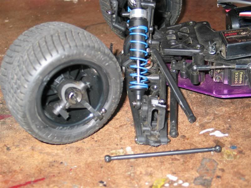

Is anyone else this unlucky, or is it just me who can barely get through a pack without breaking something?
Ran it with the Road Rages and geared 52/15.
ESC ~150
Motor ~168 great
Batteries ~ 140
Maybe it's because the high traction on-road causes so much amp draw? I don't know. Every time I have a little "accident" also, the right battery pack smashes into the pinion, which is my fault by design. Still, my patience grows thin with you Mr. Brushless MT.

Ouch! You should get some GPM aluminum c-hubs and uprights to replace the broken plastic c-hub. I got some, and they've held up well so far.
Don't give up yet!

I keep looking at the aluminum but I keep telling myself that if I'm going to buy the knuckle and c-hub, I might as well get the arms, then I might as well get the arm mount and then I can't just have it in the front so I need the rears. And that adds up to $200 or so. Then I go on tower and see the knuckles and hubs for $4.70 or whatever and I don't know.
When I get it fixed I'm going to try the 52/13 with the Road Rages and see what happens. It's seems really low to me but at least then I'd know if it's over or undergeared. It could be that it's undergeared right now and that plus the high traction is getting it hot? The cooler temps from the first run with the Dirt Hawgs were in the dirt/grass but geared pretty high 52/15, so I'm unsure.
Hmm also now that I think about it, this run was with the body on, so maybe that has a lot to do with it.

Well, I got some aluminum knuckles and the hub carriers, so they should hold up nicely. Got some more temps also. Just playing around in my yard with bursts of full throttle and a crappy fan on the motor:
