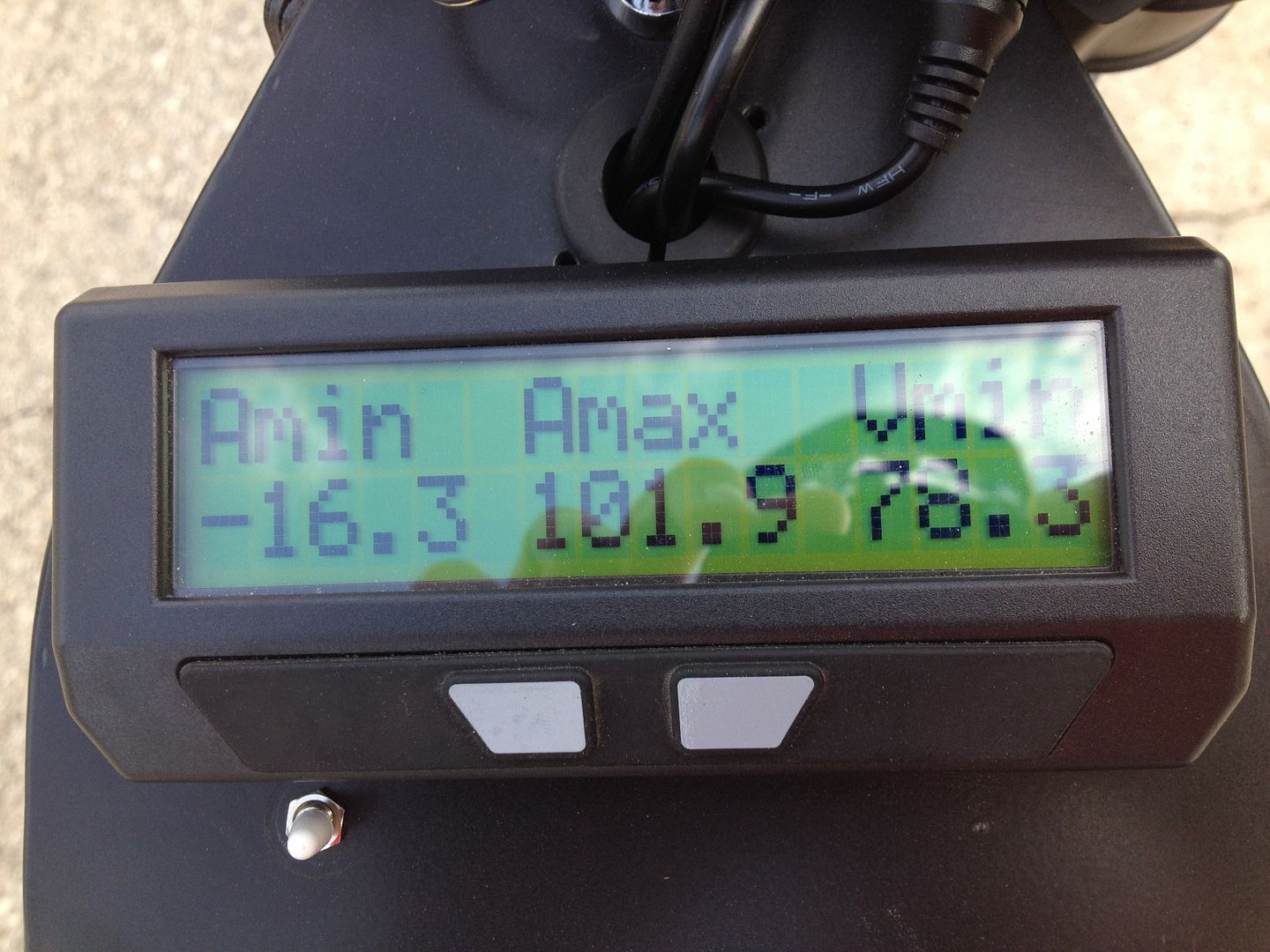

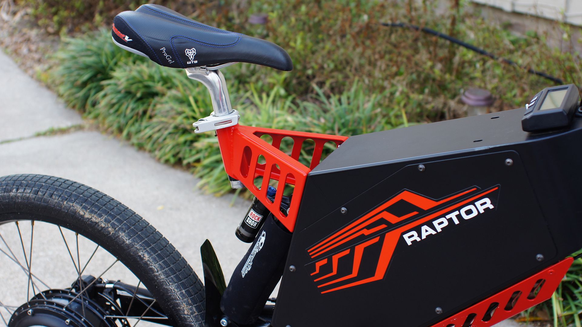

I installed my new bike seat assembly and tried out a new battery and phase current setting. Almost 11HP. Fun for offroad, but not so much for onroad.
My inner thighs don't rub anymore when pedaling with the new narrower bike seat assembly.

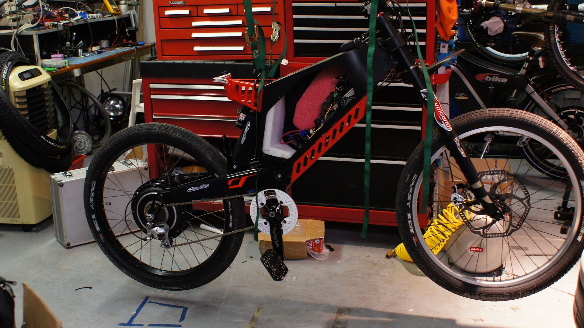

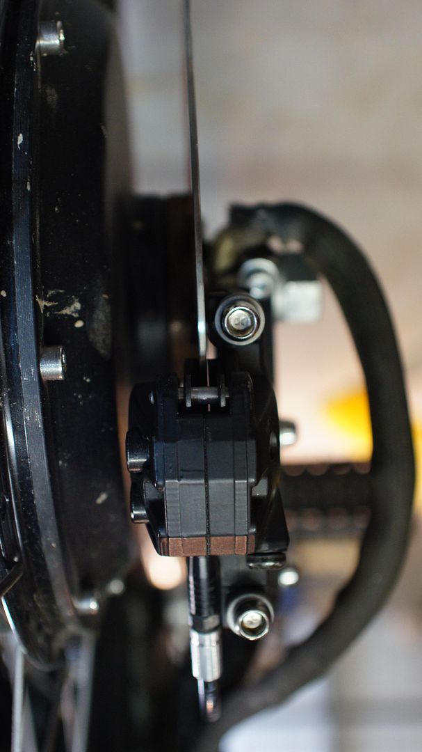

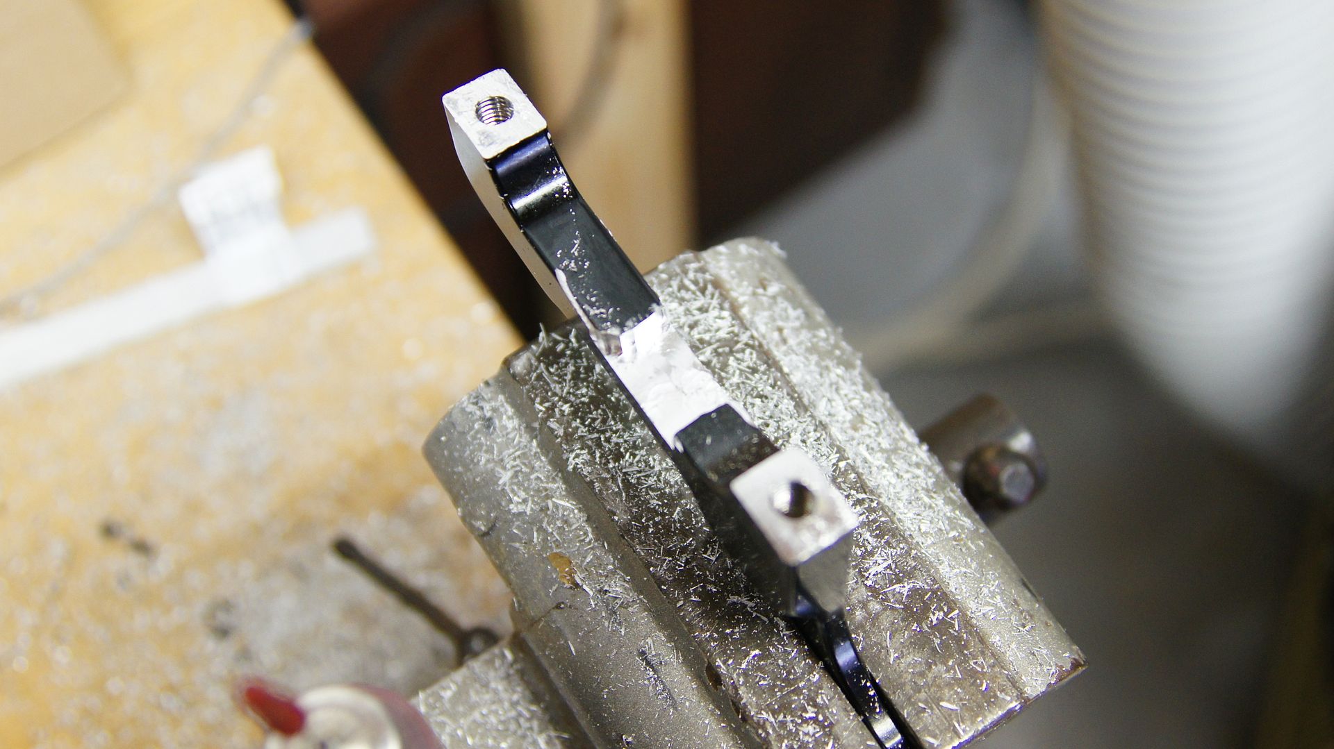

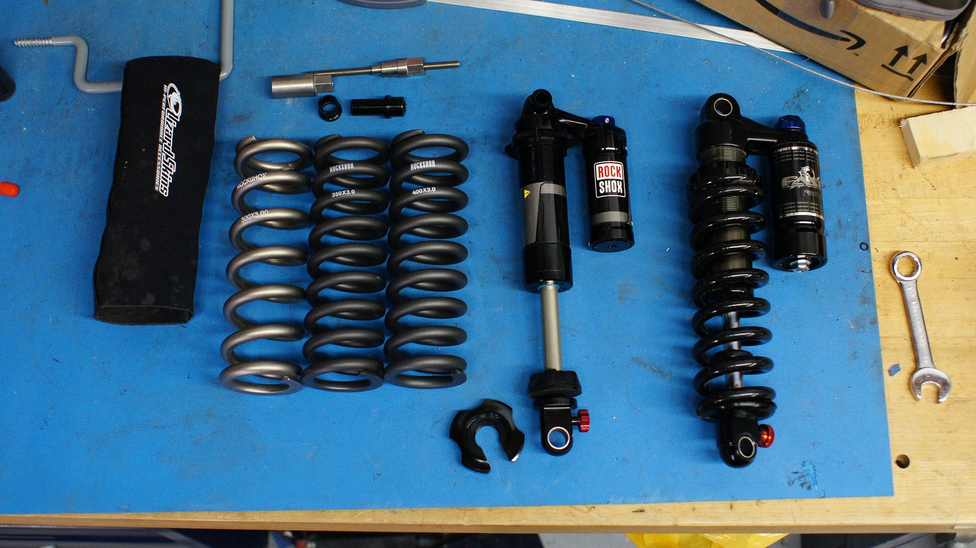

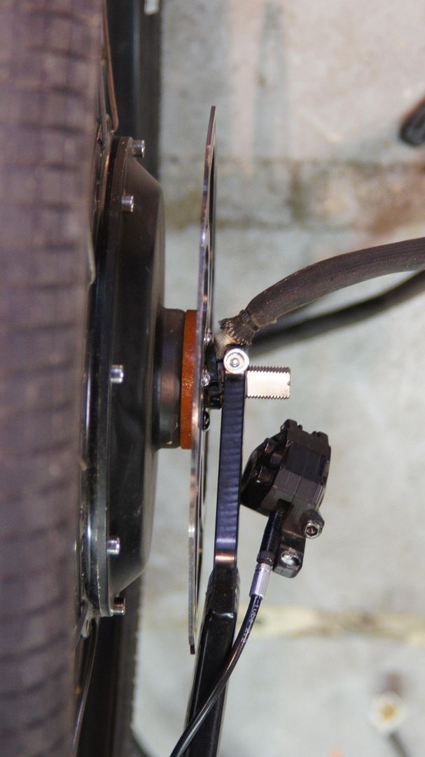

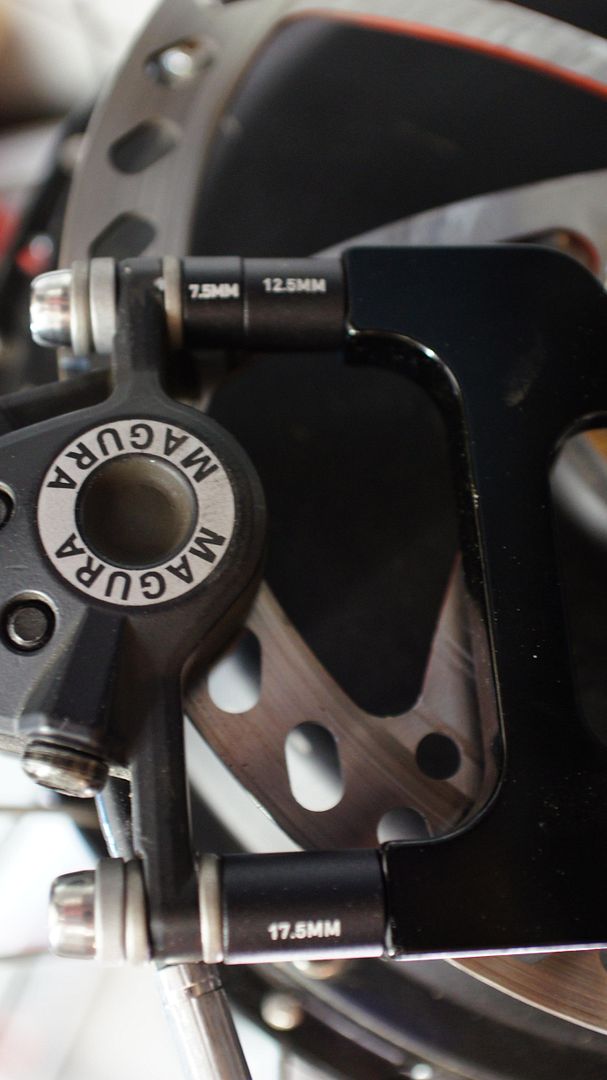

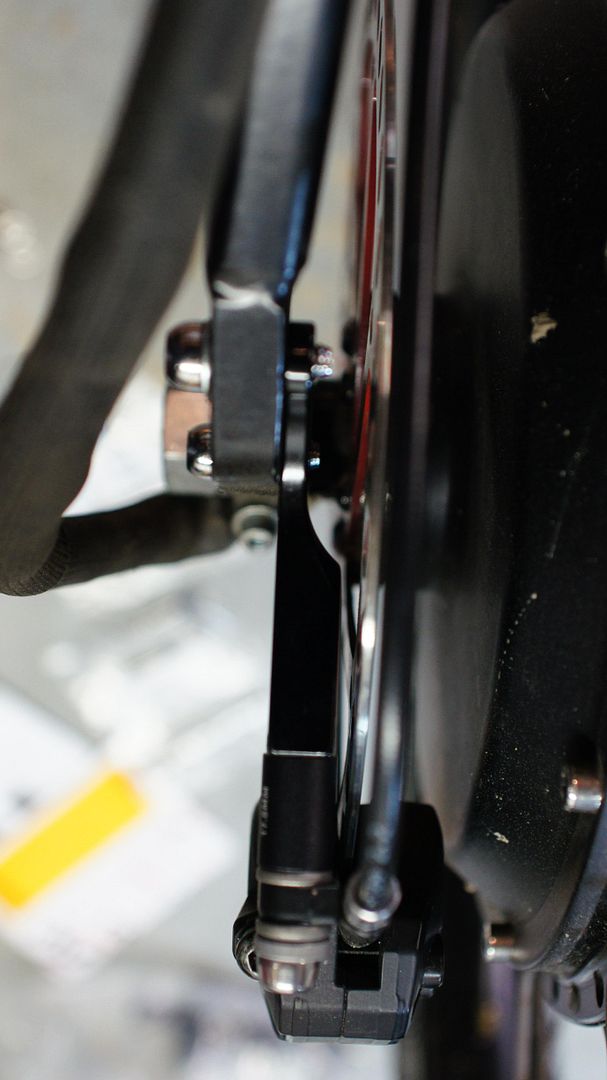

Messed around with the bike today. Swapped shocks and springs along with a new brake mount for more clearance.
Swapping springs. New spring is 400lbs. Left spring is 300lbs Titanium, center is 350lbs and right spring is 400lbs.
I just hang the bike when I work on the shock or drive train.
Shaving off some material from the original mount wasn't enough.

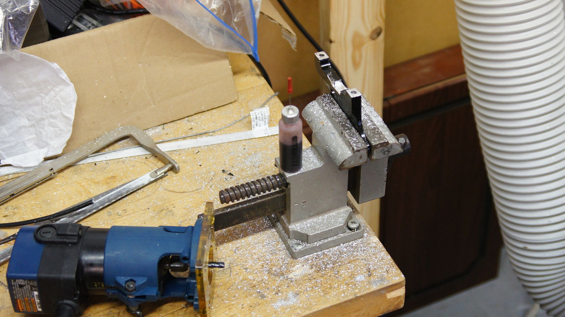

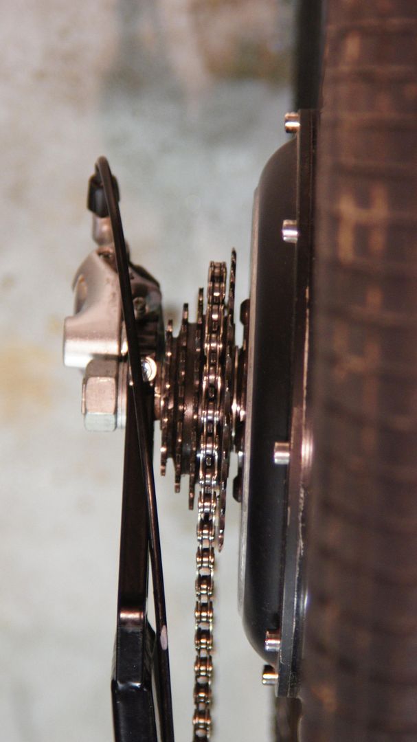

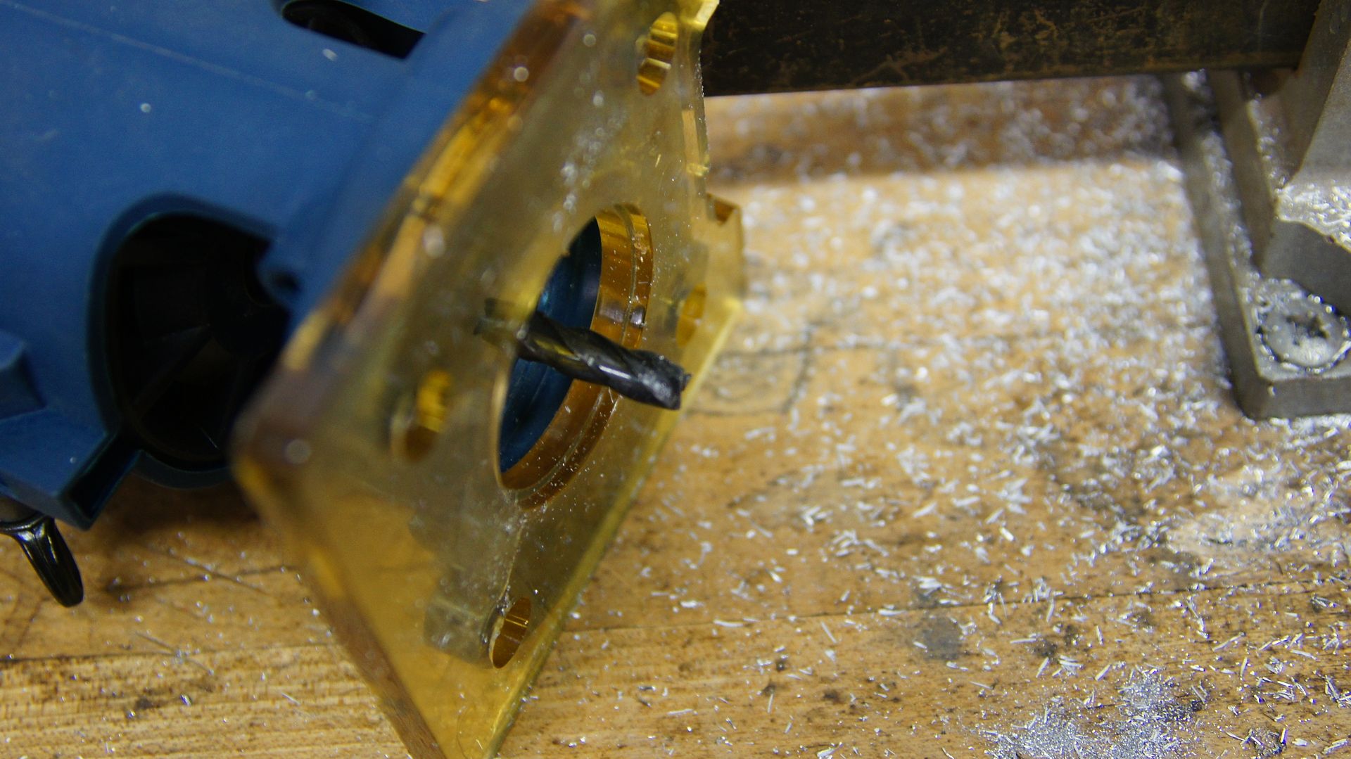

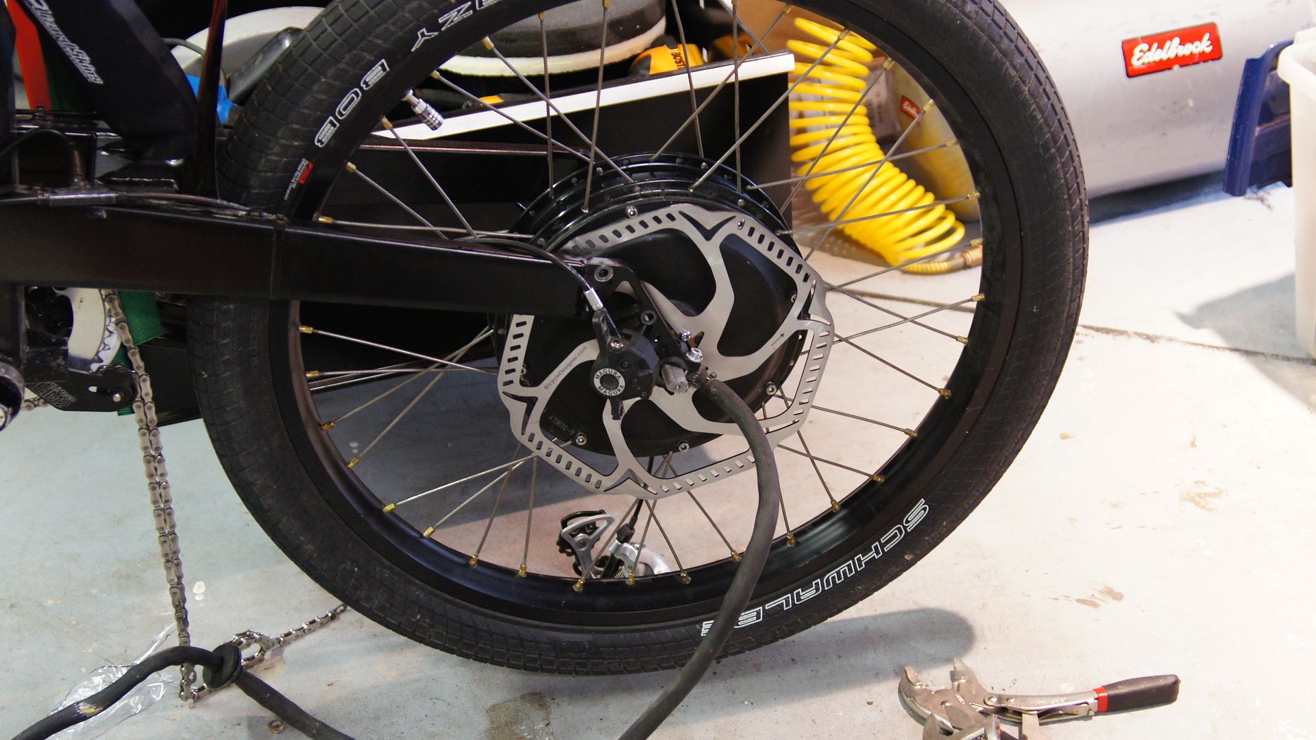

So as goofy as it may sound, I do like to pedal my Raptor around. So I wanted some more gears for the longest and decided to tackle this mission. The cheapo Chinese freewheel is destroyed when taking it off. Just had it open up the side cover and lift the assembly off. Ball bearings all over the place. Screwed on a Maillard 5 speed freewheel, with 14T being the smallest gear. I can only use 4 out of the 5 gears. The derailleur rubs on the motor side cover in 5th gear.
I used a cutting bit, 2x4, Royal Purple motor oil, vice and a router for a poor man's machining job. I got the 255mm rotor installed on the rear.
