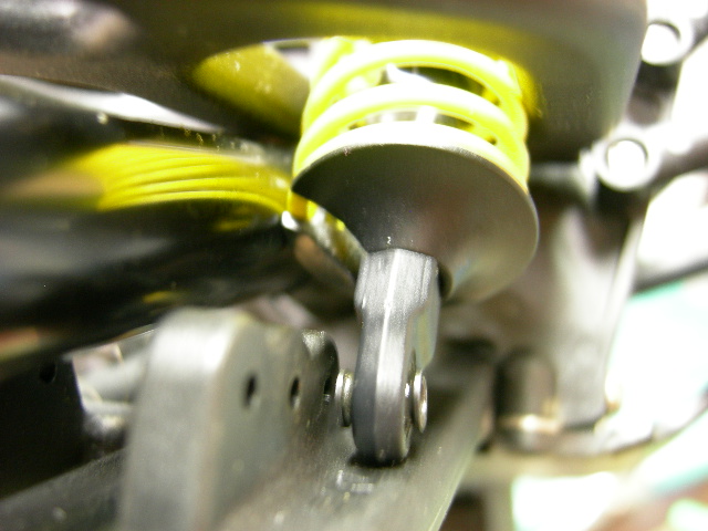

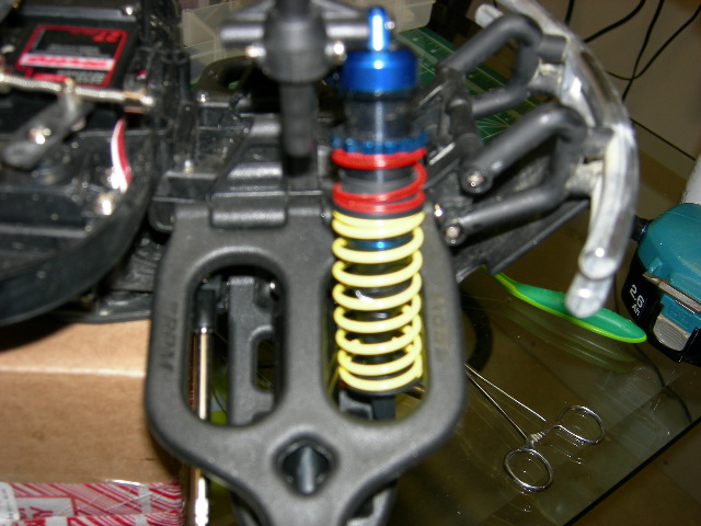

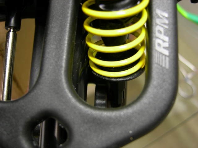

Ok, here are some pics. The problem is the spring perch sets on the slider shaft before pushing the shock over to bolt it on. If I was to shim it out to miss the shaft the spring it self hits the inside of the upper arm, in fact it hits the arm even if pushed over in the "bolted position". Its like the arm wont allow the whole shock to move any directon to clear the shaft if I tried to shim it. These are the RPM arms and the stock towers. I tried all available hole both in the tower and lower arm and none provide clearance to the shaft/perch/arms.

Ah, I see now. So, the end rubs on the shaft if it isnt shimmed, and if it is the spring rubs against the back-inside edge of the arm.... Do you have a dremel.........
I cant see any possible solution other than to enlarge the opening in the upper a-arm, or to use slimmer springs/shocks. You be buggered otherwise young'un as they say.
