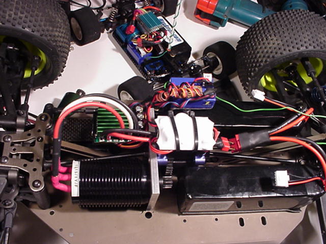

Well I have finally got my CRT going and may have some advice for you.:032:
I went with the Neu 1515 2200kv motor and it is awsome the Mamba Max esc works great but has a cogging problem with the Neu motor there is an update coming out soon I hope? I'm debating on spending the money on a Quark 125B or just wait for the Mamba Monster Max ESC?
Spurs? The stock steel spur will eat your pinions up in no time change your spur out to the Kyosho 46T nylon spur and the pinions will last alot longer.
Pinions? I found the best deal on 5mm pinions at tower hobbies in the Heli parts section used on large scale electric choppers.
Mounting the motor is easy in the CRT I found a peice of 1/4" aluminum in the garage that worked great I drilled and sloted it for the motor and bolted it to the diff mounts in the brake pad holes and 4 bolts up from the bottom of the chassis. :027:

Nice work IBJAMMIN!
How are your batteries mounted to the chassis? Double sided stick tape or what?

Very nice CRT IBJAMMIN. What battery are you running in that rc18 if I may ask?

I'm still working on the battery mounts in the CRT I'm running 2 2s3p Maxamps 9000mah packs there just dbl face taped in right now. The RC18 has a Maxamps 4s 2100HV pack. :)
