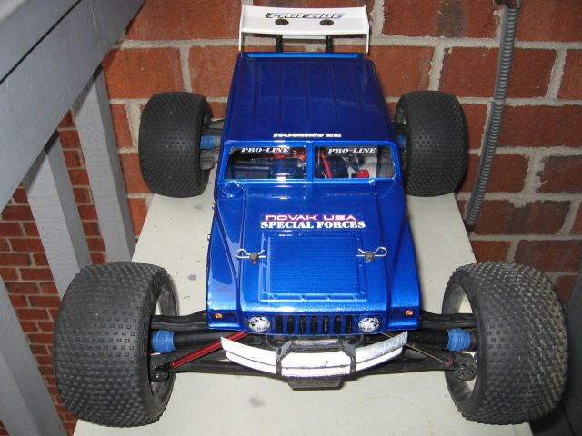

here is a bash body i painted this weekend

Looks good. Now time to get it dirty!!:027:

Nice! Looks similar to my old revo, that body lasted 6 runs ;)

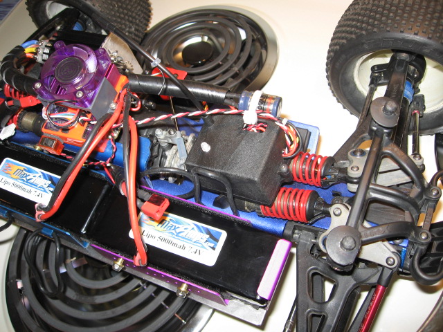

  (#56)
entjoles
some new pics of batterys on truck - 04.13.2007, 09:45 PM

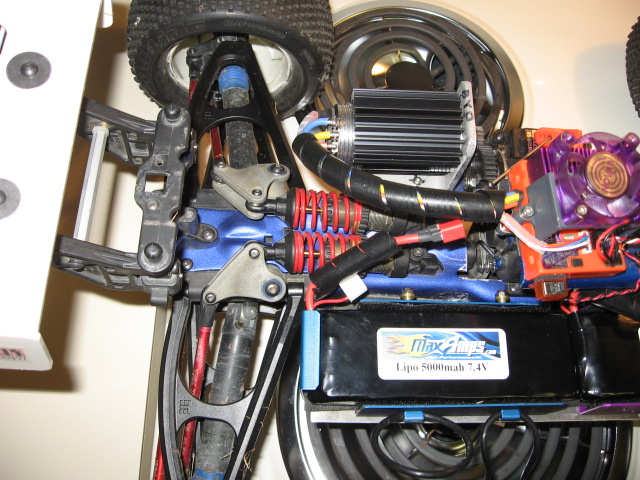

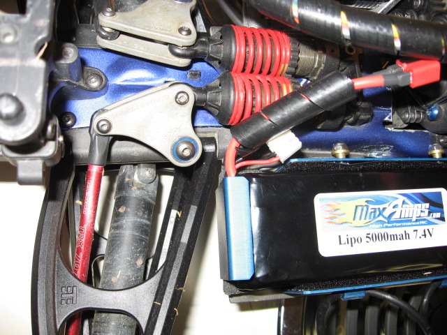

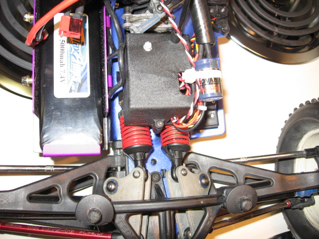

here they are mounted
ID:	2740   Click image for larger version
ID:	2741   Click image for larger version

You don't have to get rid of the center diff if you lock it in 2nd. Try thicker fluid in the center and if the front starts to unload on one side or the other in a turn, the go thicker in the front. Theres a sticky about diff tuning basics.
