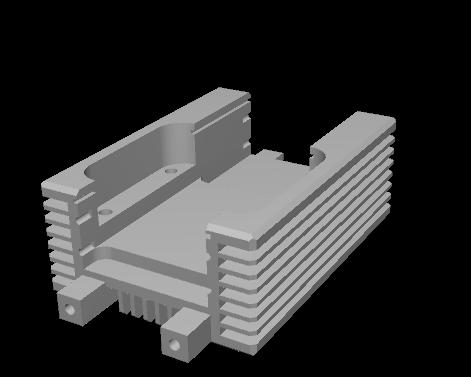

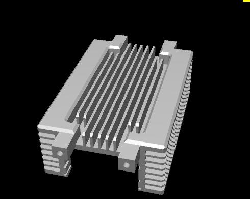

06.07.2007, 07:52 PM
Here is the case with Edge Chamfer instead of Fillet. Also, the bottom is modified to make it easier machined. I asked Mike if it were a good idea to chop the bottom off of it and use his heatsink for bottom and mouting, to reduce costs of course.
Name:	Quark v 3.JPG
ID:	3040   Click image for larger version
Name:	Quark v 3 (2).JPG
  (#51)
snellemin
2 KiloWatt RACER
snellemin's Avatar
Posts: 2,496
Location: Houston
06.07.2007, 09:27 PM
How much would this cost? Really nice case designs.

  (#52)
zeropointbug
Z-Pinch racer
zeropointbug's Avatar
Posts: 3,141
Location: SK, Canada
06.07.2007, 09:34 PM
Thanks. :dft009:
I have not got a price back yet for it, from Mike. Although I am not done designing it, and MIGHT make it flat bottom so it can be used with his Monster esc mount. We will see.

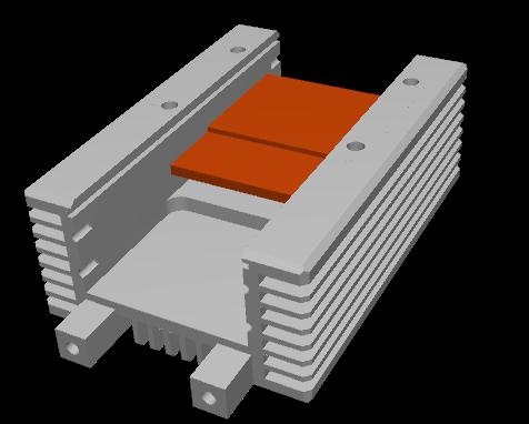

  (#53)
zeropointbug
Z-Pinch racer
Posts: 3,141
06.07.2007, 11:04 PM
That's with the updated heat spreader and clamps. Notice the small slots for the top cover to slide into?
Name:	Quark v 3 (3).JPG
